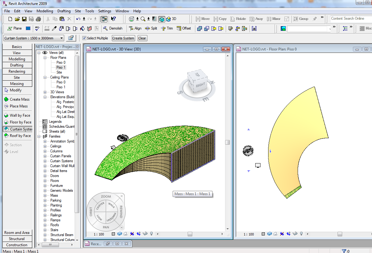

What technique or tool can I use to model this facility in Revit?

I would start with the massing tool and then use wall/roof by face.

What exact approach should I take in massing the building?

Try "Solid Swept Blend"....

Ok,with the sweep blend I can only slope up in one direction. How can I form the full upward and downward curve of the roof?

You can achieve that with a combo of swept blend solids and voids...... or just wait for the new release of 2010, the new Revit 2010 will be able to model this with ease... check it out.

You could combine different masses into one in-place family and or model the mass in a program with more flexible massing criteria like sketchup or max.
