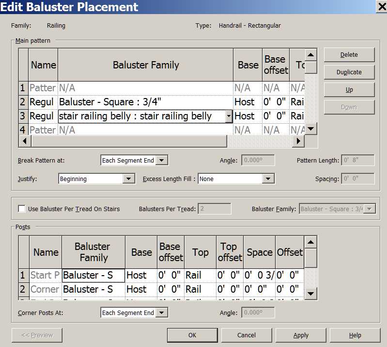

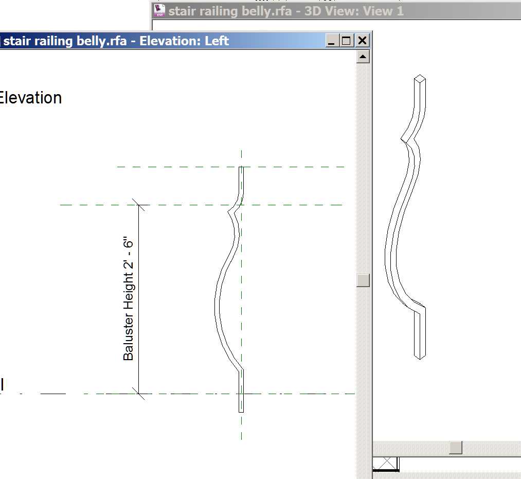

i am trying to make a railing.  i made a "new family" and picked the "baluster-post.rft"   i made a functioning 3d object (see attached).  When i try to select it into the railing element properties it says:  can't make type "stair railing belly" (that's what I named it).   why not?

Railings must be created as profiles.
Can you post your family?

see attached.  It was created as a new family/baluster-post.rft not as a new family/profile.

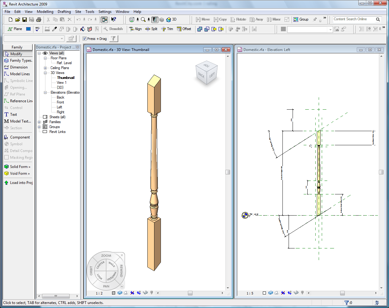

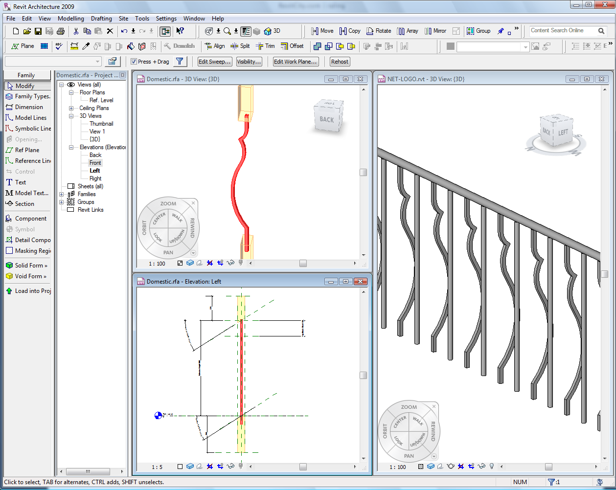

Hi, I insert your baluster in other family and adjust the parameters only....

Into this family....
