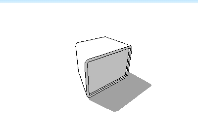

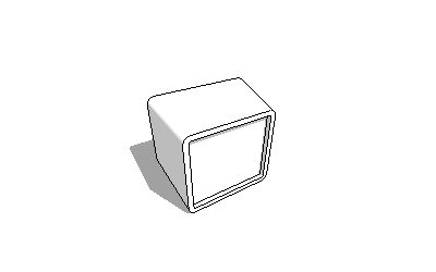

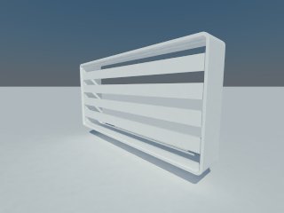

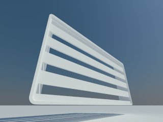

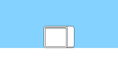

Does any know if it is possible to create like the one illustrated in Revit ?

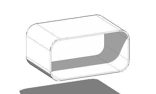

I have tried to create a solid - and then used "Wall by face". I can then create the form like shown on revit.jpg.
But I can't close the form by adding walls on the other two faces :-(

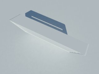

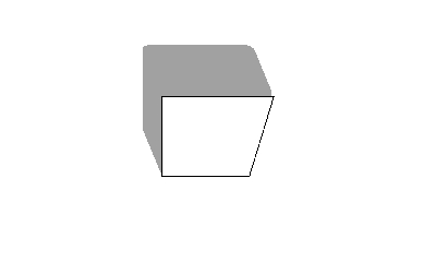

And I can't figure out how to give the form the twist / cutoff - like seen in plan.jpg.
Can anyone help ?
Thanks

"Does any know if it is possible to create like the one illustrated in Revit ? " - Are you kiding, right???? - Create in place in the category you want (walls, generic, whatever) in one piece...
"But I can't close the form by adding walls on the other two faces" - If you trying to create walls in TOP and BOTTOM of the object, of course you CAN'T, you CAN use ROOF or SLAB...
"And I can't figure out how to give the form the twist / cutoff - like seen in plan.jpg" - what?? the image with "blue floor"???? - simple, SOLID BLEND
YOU WELCOME....

Sorry - but can you explain how you would do it ?
I can't find the 'bend' tool you describe ?
It's not the image with blue background, but the one named plan.jpg that shows the 'twist'

Solid blend is the tool you are looking for. With it you will set a bas and a top which can be side ways and REVIT will connect with a smooth blend.

Hi, see the video: 1º Video: http://www.megaupload.com/?d=IYNQ3R0G   2º Video: http://www.megaupload.com/?d=QZK3I8H0

Thanks a lot. I'm honoured that you created such a detailed tutorial.
 I've got it made thanks a lot :-)
