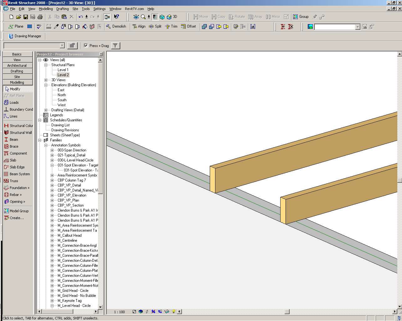

Is it possible to make Structural Beam snap on the Exterior Core face of a wall, instead of snap on the center line of a wall? or any possible way I can make the end of Structural Beam set on the Exterior Core face of a wall? Beacause I am drawing a timber framing plan, and the ends of timber joist should set on the exterior core face of its bearing wall in timber construction.

I am having the same problem, hope somenone can answer this.

Hi
Yes this is possible, but it will depend on your beam family. Have a look at the attached files, not you need to adjust the start and end extensions to suit the width of your wall/beam

Thank you antony, its working fine now
