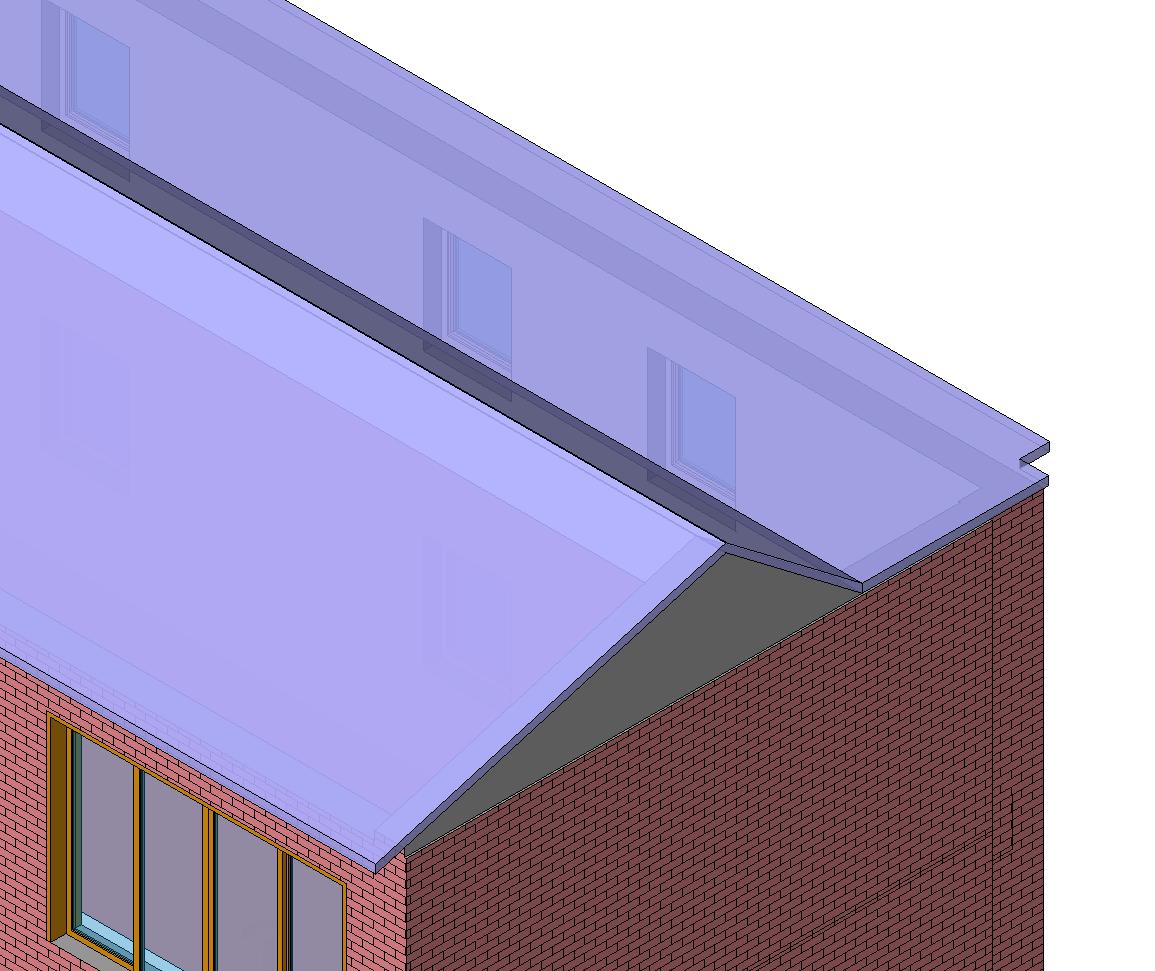

When i attach my wall to roof then material dont follow the wall.
See attached snapshot for more details.
Cheers

Because you have that "Layer" (brick) Unlock, so, detach that wall from the roof, pick in the wall, go to properties>Edit/new change for section view and check in the view when you pick in that layer (modify) if there is a "Pad Lock" UNLOCKED?? if so LOCK....

THNX TYPHOON
