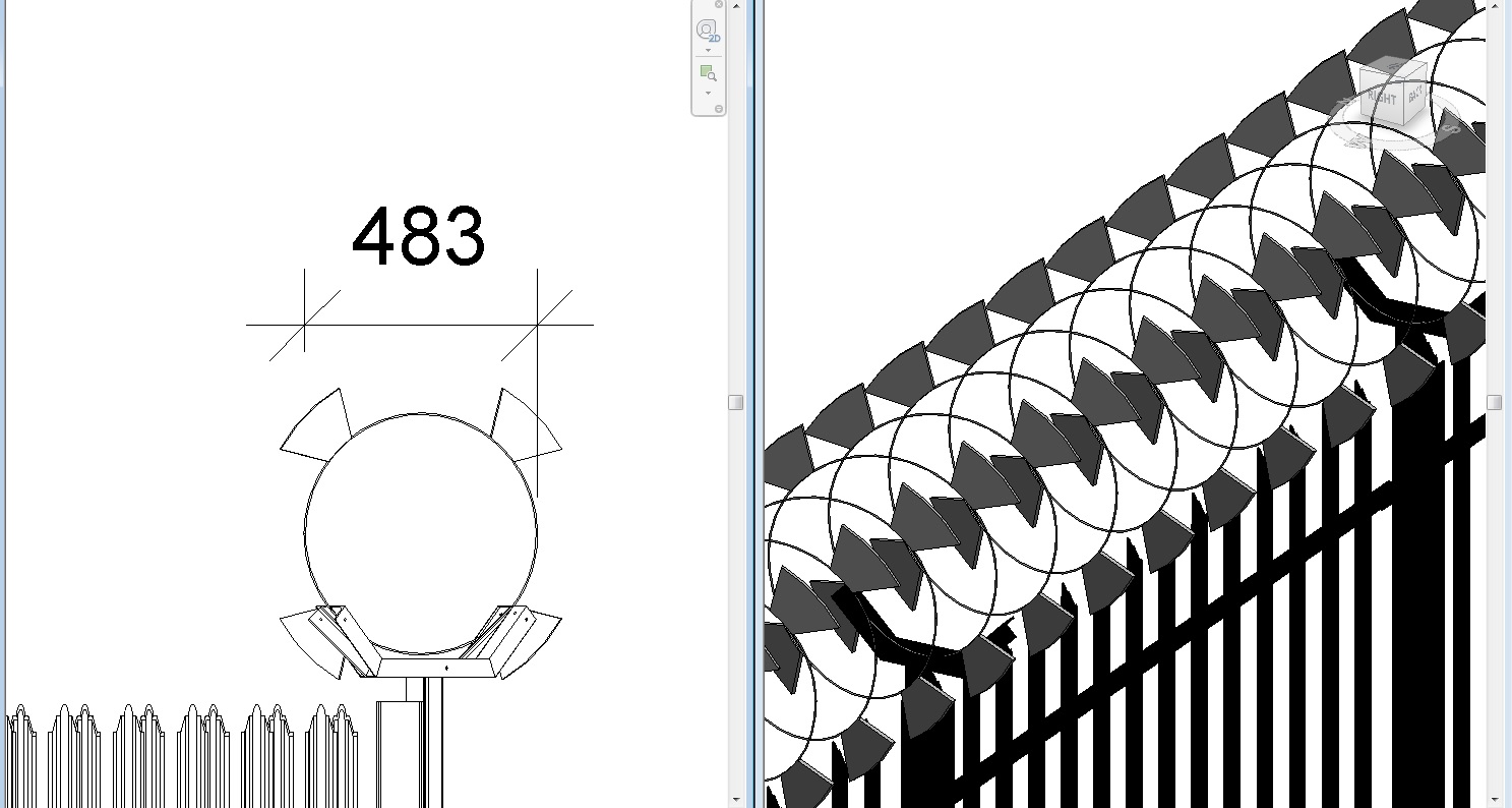

Does any one have an idea of how to create a parametric razor wire (3D) family?

Here is a ribbon razor family... BEWARE!!! It will blow-up your file size. I suggest putting in on it's own workset or even in it's own file that is linked.

I feel like a total idiot for asking, but does anyone know how to tweak the diameter of the coil? I have limited Revit experience, and I really need this family in my project! Thanks in advance

Hi Shatner86,
Thank you so much for your assistance and time thus far.
The last question I have is: How do you reduce the size and increase the amount of blades? When I set the coil radius to 250mm, the blades are really big as shown on my 1st screenshot. Screenshot 2 shows you how far I get, but this is where I'm stuck. I tried to modify the sketch lines after unlocking the constraints, but it doesn't work.
Thanks again for your help!

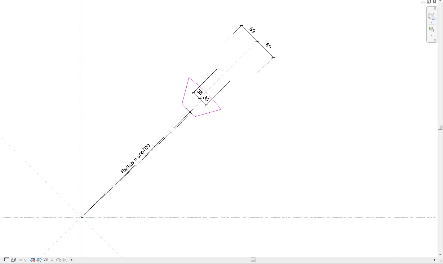

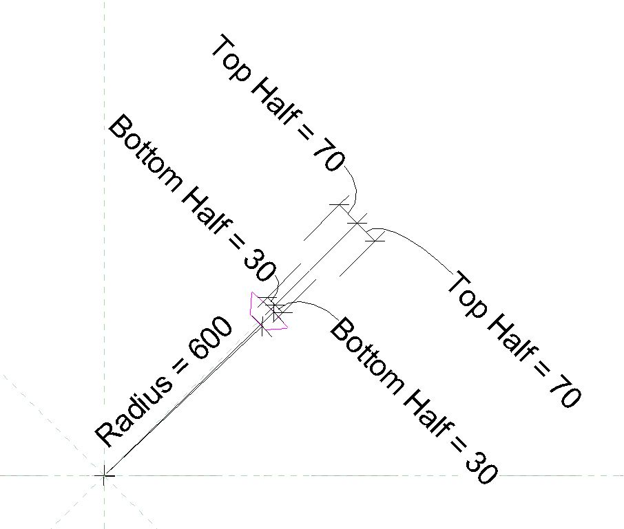

Firstly, size of the blade.
So, to start. To change the height of the blade, easiest method would be the change the "Cal" parameter's calculation (within the blades family). So I have it as 'Radius + 100'. Change it to like Radius + 50 and you get a smaller blade.
To change the width, what I did just now was to convert the dimensions into a type parameter. So I changed both of the 35mm to "Bottom Half" and both of the 89mm dimension to "Top Half". Then within the Type parameters I just fiddled with the numbers to get it to a better size. (See attached)
NOTE: You have change the dimensions in the other blade extrusions within the family!
You could carry this functionaility through to the host family, if you like. Make parameters instance and link them within the "Coil" families as instance parameters.

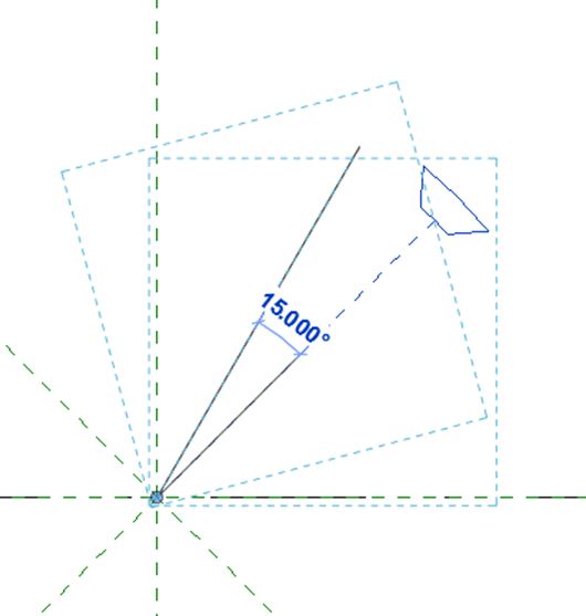

Second question, the number of blades, well I'd do what I did to create them. So select the reference line and the blade extrustion and rotate from the origin point in the centre. (See attached)
NOTE: The blades have a visibility controls applied to them, so whatever you do to the top half repeat on the bottom.

That fixed it! Thank you so much for helping me out. I've learned valuable skills through this exercise.
