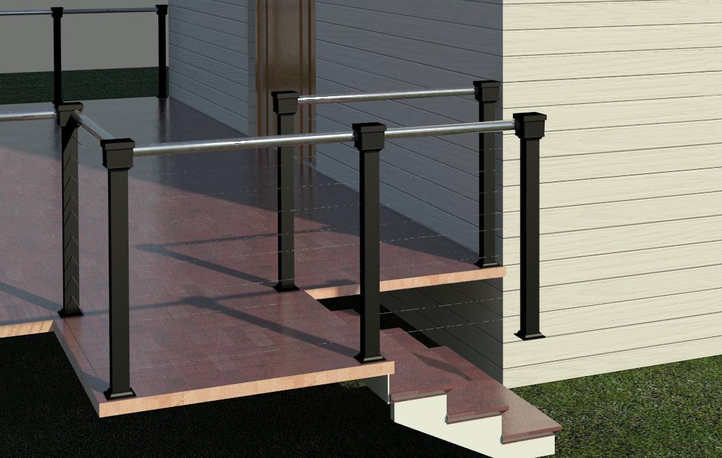

Can Someone show me how to attach the railing to the deck stairs?
Wed, Mar 25, 2009 at 7:01:11 AM | Railing Help
Railings are sketched by line segments with each segment representing a straight-line (bot x & y directions) portion of the railing.  In your railing sketch, you need to split the sketch line at the stairs.  The line over the stairs has to be hosted by the stairs.
