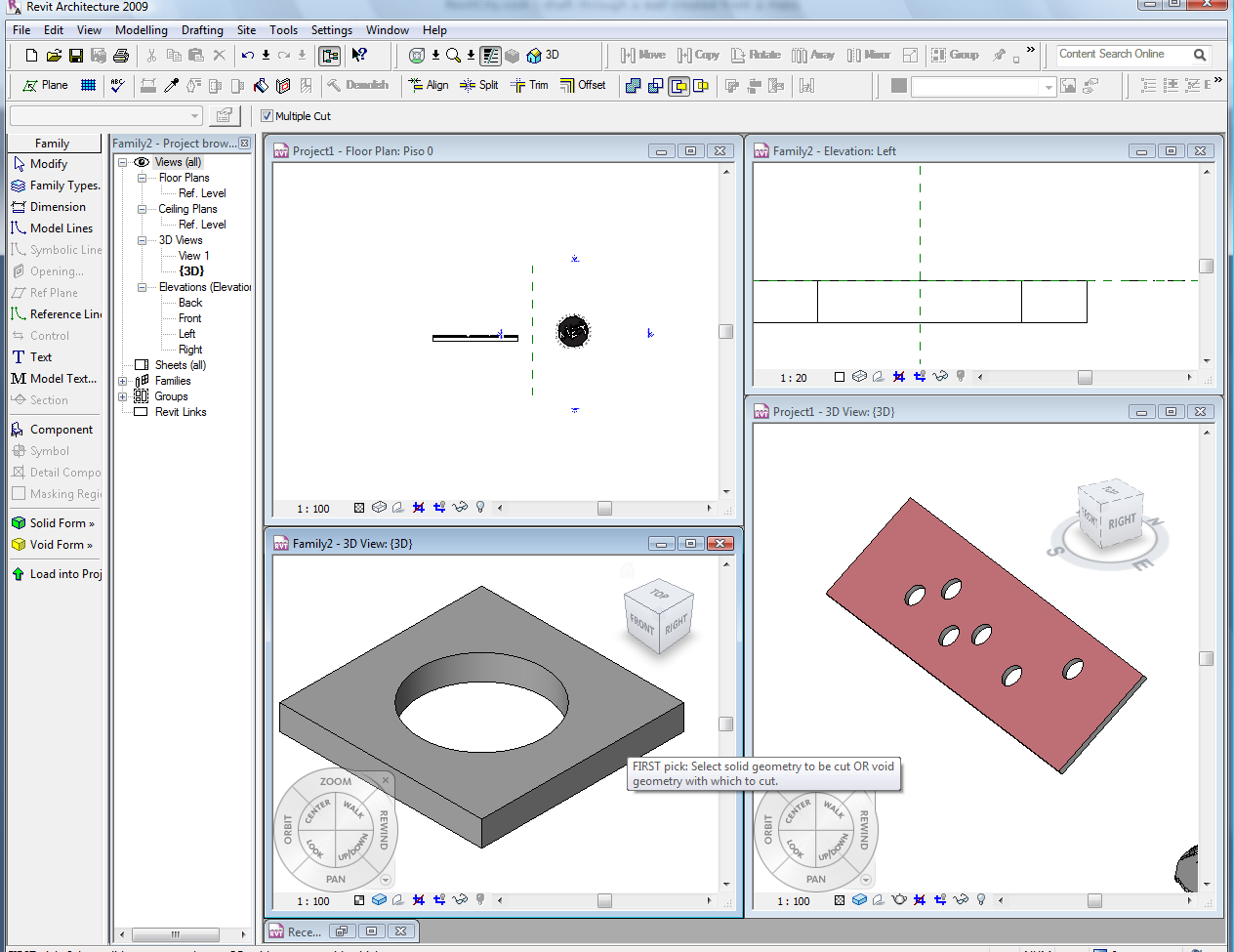

I have created walls(non-vertical) from the faces of a mass and I need to cut circular openings through them. I created a shaft opening but it doesn't cut through those walls. How can I make openings in these walls? I'm using Revit 2008.

I think i create a "Generic Model Face Based" family with the "Void"....
