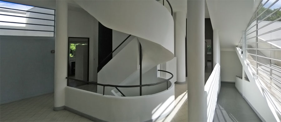

I'm trying to create Corbusier's Villa Savoye stairs in Revit and I cannot get my railing profiles to cooperate because the handrail requires 2 closed loop profiles in 1 file; the pipe rail at the top and then the rectangular wall rail beneath it.  Please see the attached image to understand what I'm trying to do.  Perhaps there is a way to have 2 seperate handrail profiles for 1 stair set, or maybe their is a wall to have a wall host to a stair and then I can attach the pipe handrail, I do not know I hope someone can help me.
 Thanks in advance

You should be able to edit the railing's type properties, and under Rail Structure clikc the Edit... button. You can then Insert a second rail with a different profile and give it a different height, offset etc. HTH

Brilliant, thank you
