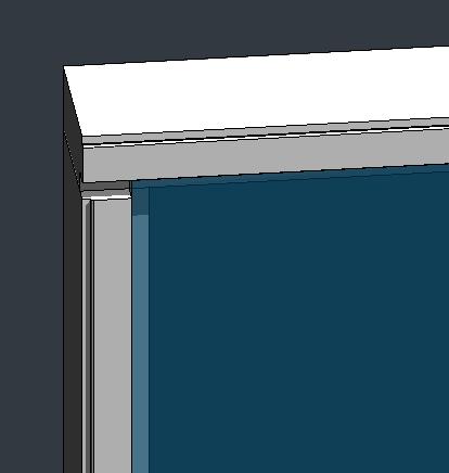

Hi there. I've made a new capless curtain wall system (panels & mullions) but the corners of the border mullions around the glass look bad. Is there a way to miter these? I've attached a picture to further explain. Thanks!

Currently there is no way to mitre curtain wall mullions...  Add to the wishlist.

Thanks Chris. That's too bad. Is there a way to edit the extrusion length of mullions, not just the profile? maybe  I can stick a custom corner peice in there? Or am I wasting my time? Cheers, Corrinna

I just downloaded 2011.
Upgraded a project.
Still no mullion mitering.
The only two options are "make continuous" and "break at join" - the same crude options from previous releases.
