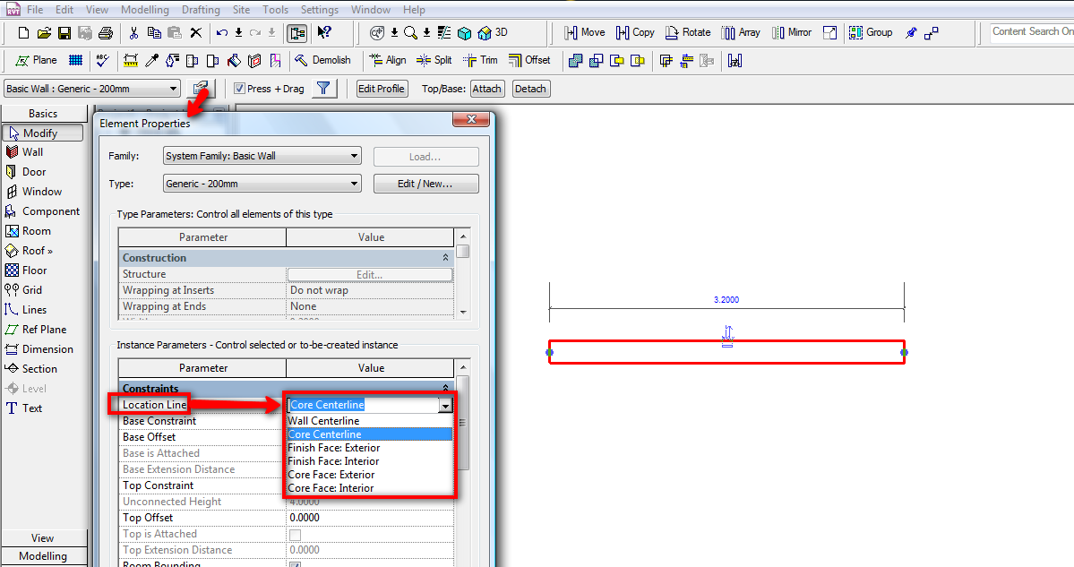

i created a wall with the location line set to "wall center line".  how do i change the created wall's location line to "Core centerline" without drawing new wall nor aligning????

Hi copperevit, are you talking about this? (see image).....just pick the wall and in "element properties" you can change it in "Location Line"....
