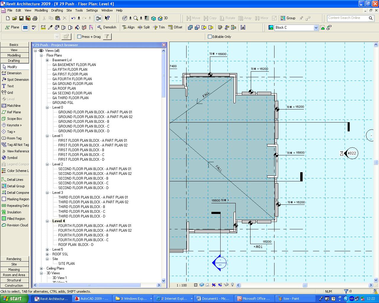

HI,Please refer the attached image; i need to add TOW as a prefix to spot elevation. I did this by adding TOW as a symbol but i have to create for different directions so that i can use 4 sides of my building/plan. Can anyone tell me do this in better way!Thank you

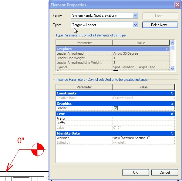

When you place a spot elevation, you can click on its properties and you can set a prefix or suffix to the value.

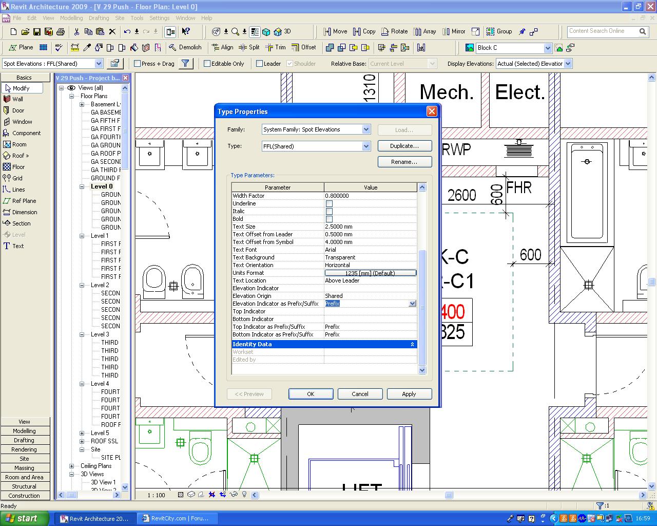

sorry i could not found anything like that

Here is a screen shot....  Element properties.
