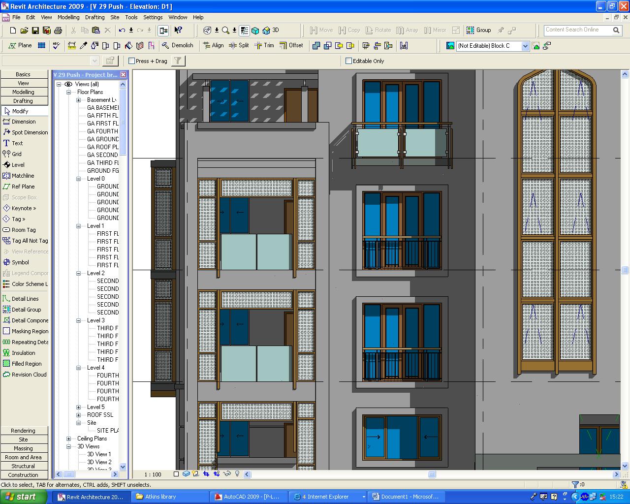

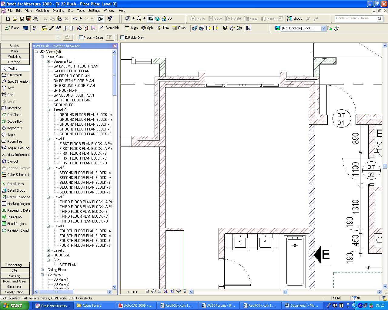

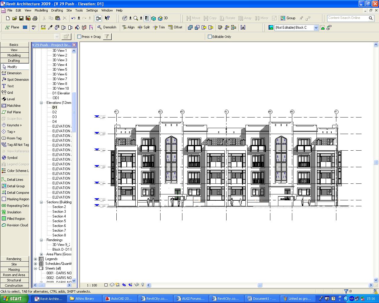

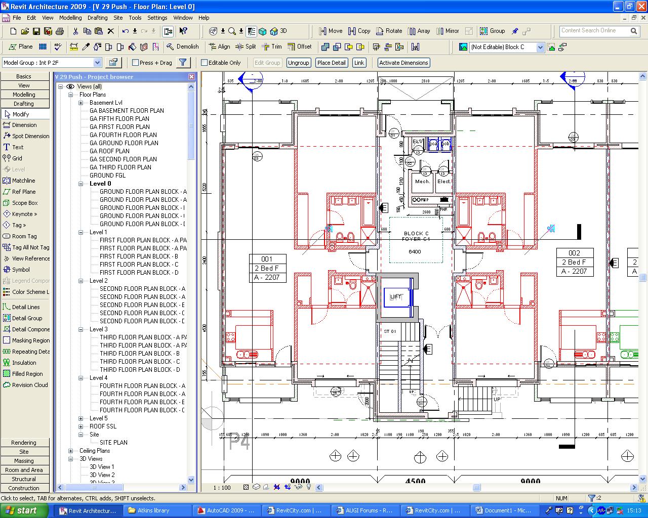

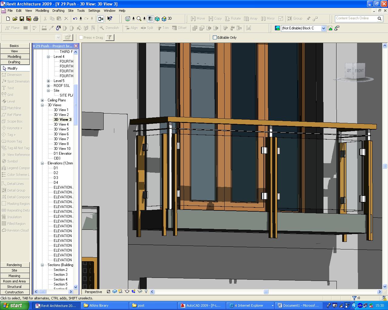

Thanks for all forum members, Please find the attached image of my building in revit 2009 (the model intension was not to render) to some extent i solved all problems. if you want to know more abt the issues u can refer my old posts.The following are the issues and solution 1. Coordinates issue - Moved cad files to origin in auto cad2. Plastering layers not wrapping properly - i not used it, i offset my slabs 5 mm inside so that it’s not visible in elevations3. Thrmal wall wrapping @ Door/Window junction - Added wall closer reference plane in families4. Linking files issues (too many unit plans)-Loaded file as groups so for so good!5.Screens issues in elevation - used plain glass with hatch (till now i could not find a way make this in 3d or render it look like 3d, that’s y in rendered images the screens are empty) Un resolved issues1. Hatch pen thickness – not able to reduce2. Elevation tag not able to customise to our company standards3. Balcony railings – not able to do it railing so I made that as generic family4. Not able to show Structural slab level and finished floor level in floor plan (Eg SSL-2300 and FFL-2375)5. Not able to show false ceiling height in floor plan.
