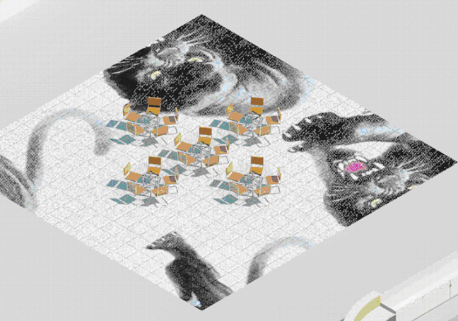

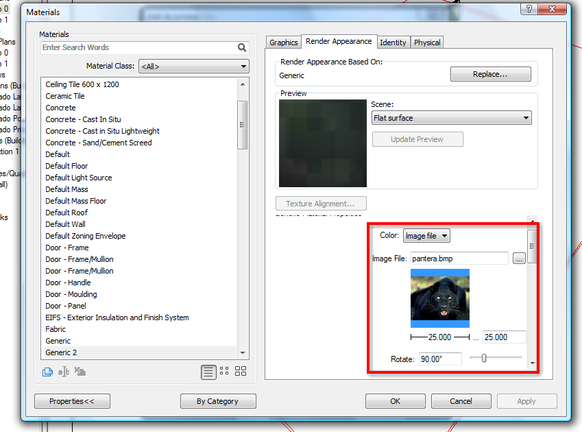

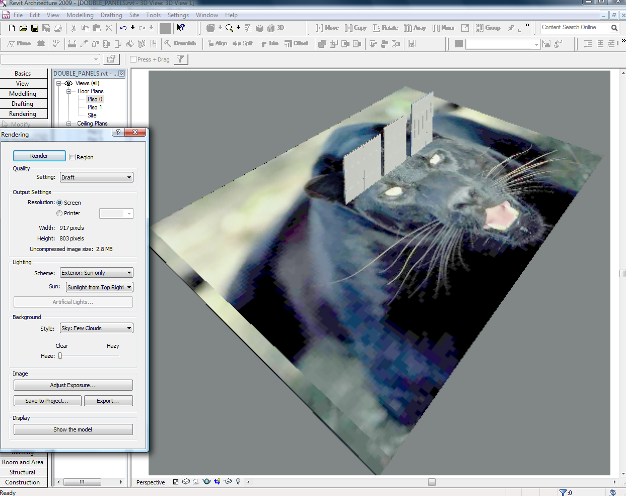

I have a problem in Revit Architecture.  I am designing a floor for a room with a big tile design in the middle.  I set the floor to a finish and put an image file in for it.  The image is a big panther, however, every time I render the image the panther is not centered.  Instead of one large centered panther, 4 pieces of one show up, off center.
I have done everything I can think of, can someone please help?
Thu, Mar 12, 2009 at 1:36:50 PM | Image File not Alligned?
It looks like you used this as a finish material instead of a decal and the pattern start is in the middle of your space.  I'm not sure how you can control this.  But if you place this pattern as a decal on the floor, it should work.

You must adjust the values of the image....

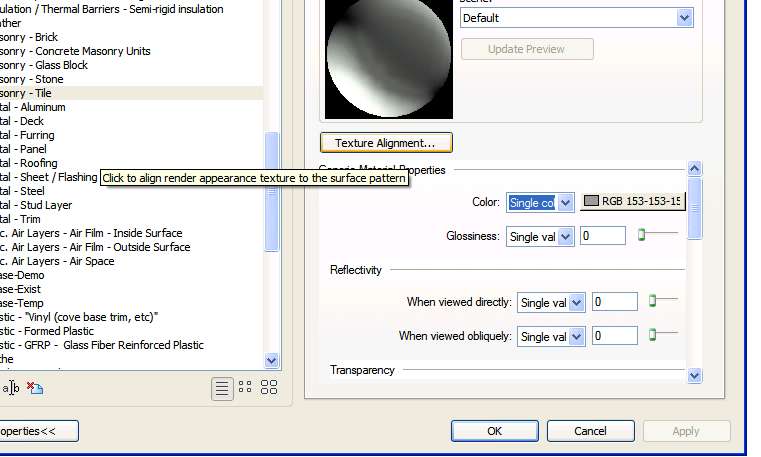

what you really want to do is use the texture alignment tool in the material rendering settings to align it to the shaded view surface pattern:
