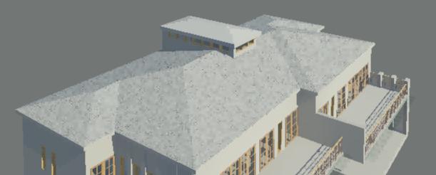

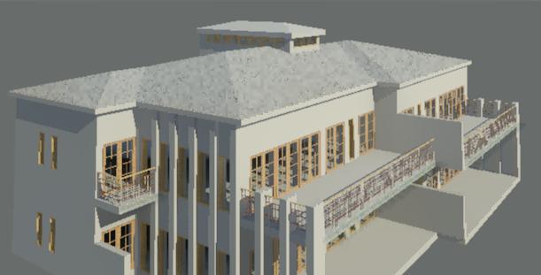

I've attached to basic perspectives for the renderings I'm trying to achieve. I need a red barrel tile roof on top.

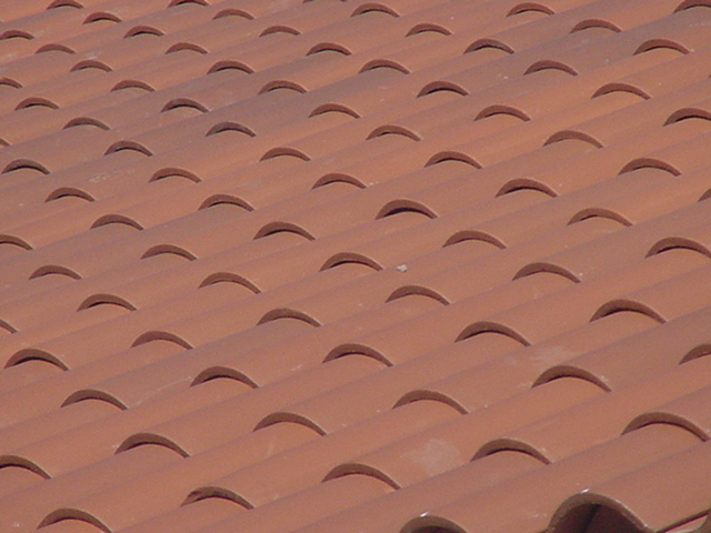

i think you mean a spanish tile roof?  Like the one pictured.  I have seen several threads in the forums on ways to do this type of roofing.

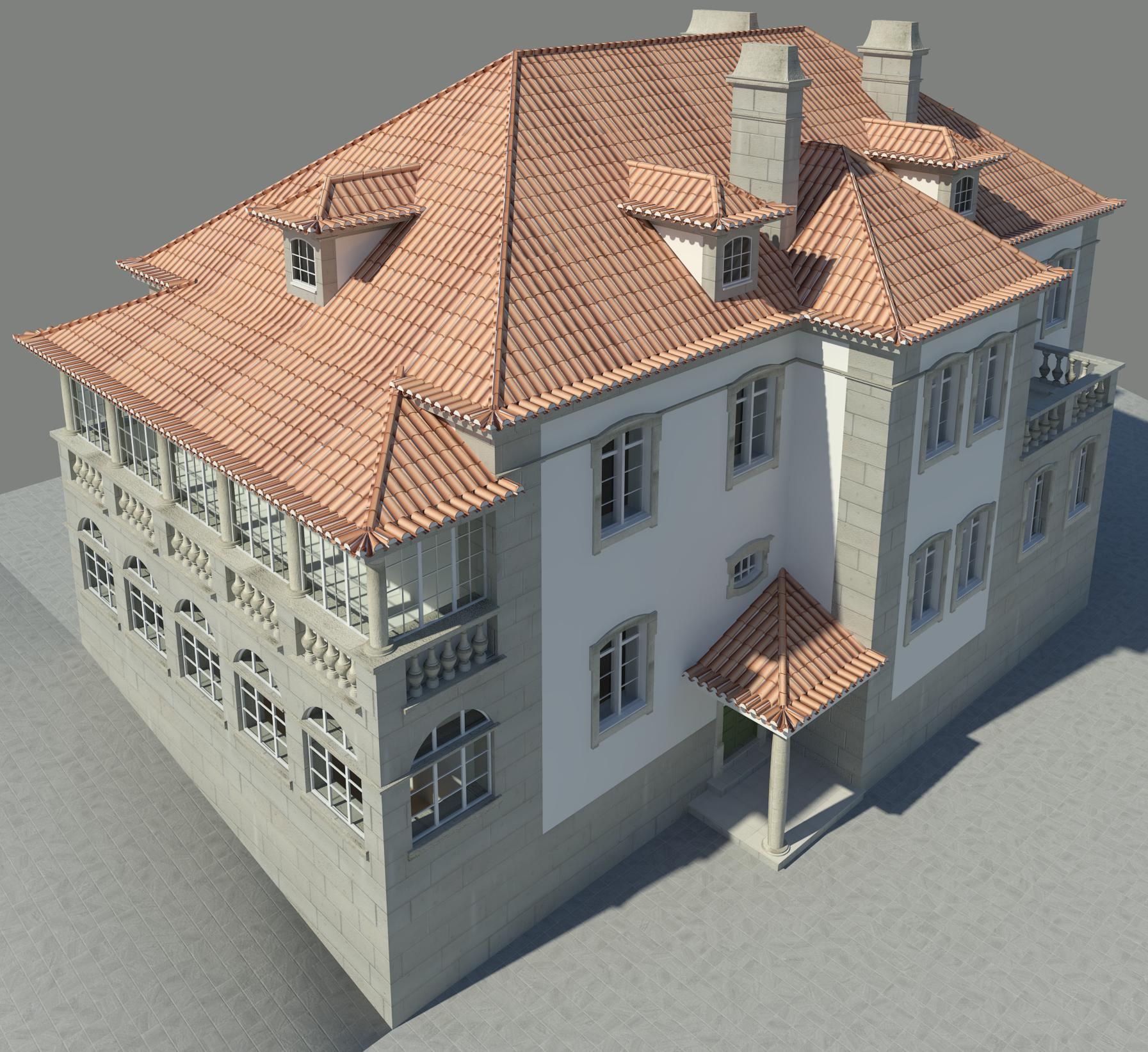

Go to my Profile and check in my "Gallery images"...

Did you see my gallery images???
Is this what you want????
