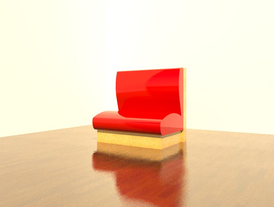

I am a student in The Art Institute of Las Vegas and I've started a project with Revit. I have found several families in Revit City, some of them I've been able to change the materials and colors and others I haven't. Can anyone help me make changes, for example a single banquet I found, I would like to change the color of the seating, when its being rendered the default color shows up. I've tried editing the family it self but I get stuck when I can't find the same screen when you change the materials in other families. Also, there is a flower vase, when its being rendered the flower is in default color, how could i change the color of the flower?

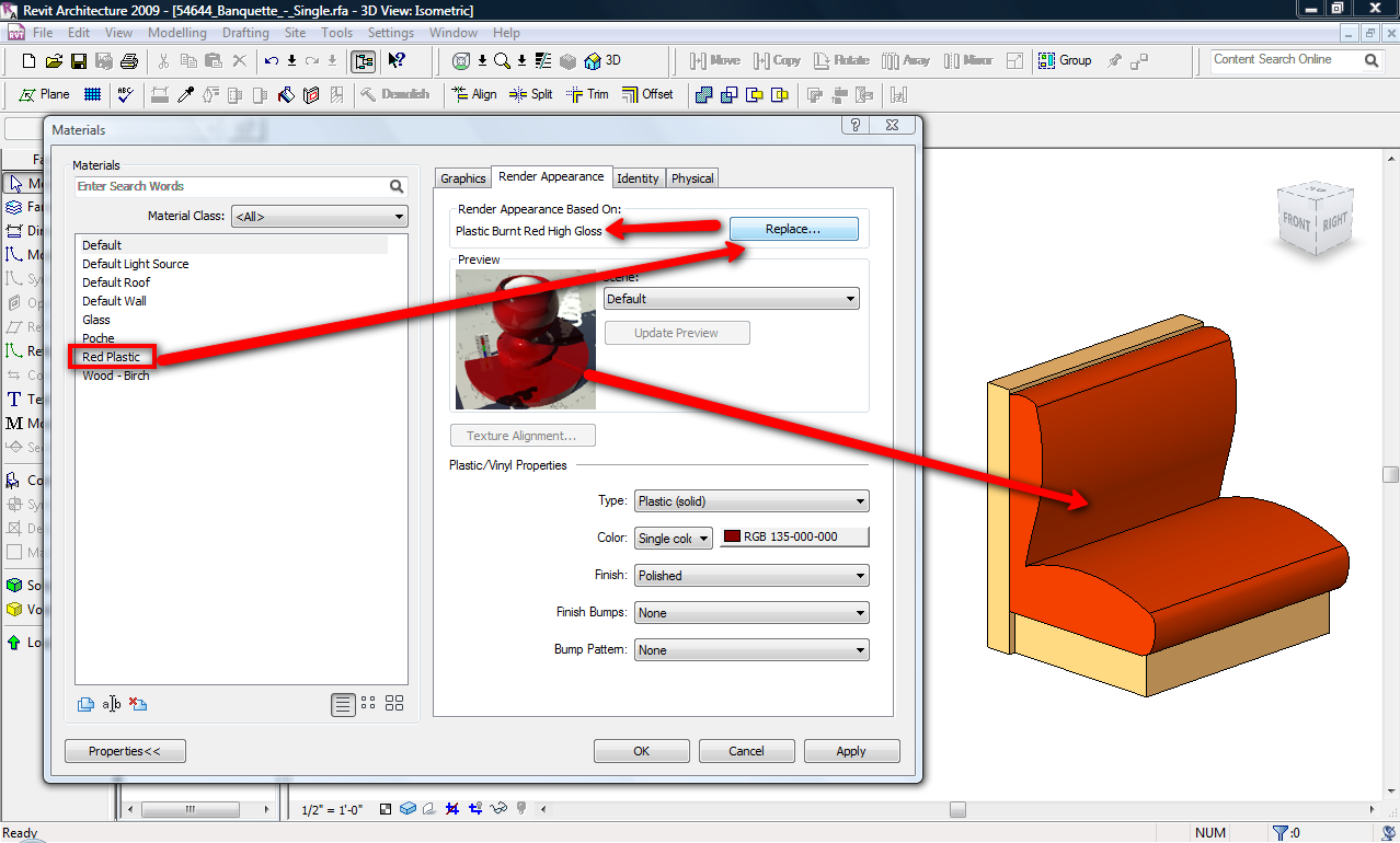

Hi julixa, " I've tried editing the family it self but I get stuck when I can't find the same screen when you change the materials in other families." (?????) Assuming you have RAC 2009, open your family file go to settings>materials..., there you will see the materials for your families, i.e. your banquette has 2 materials: "red plastic", and "wood-birch". What you have to do is simply update the materials by changing them (see images), the same for your flowers...hope it helps...
