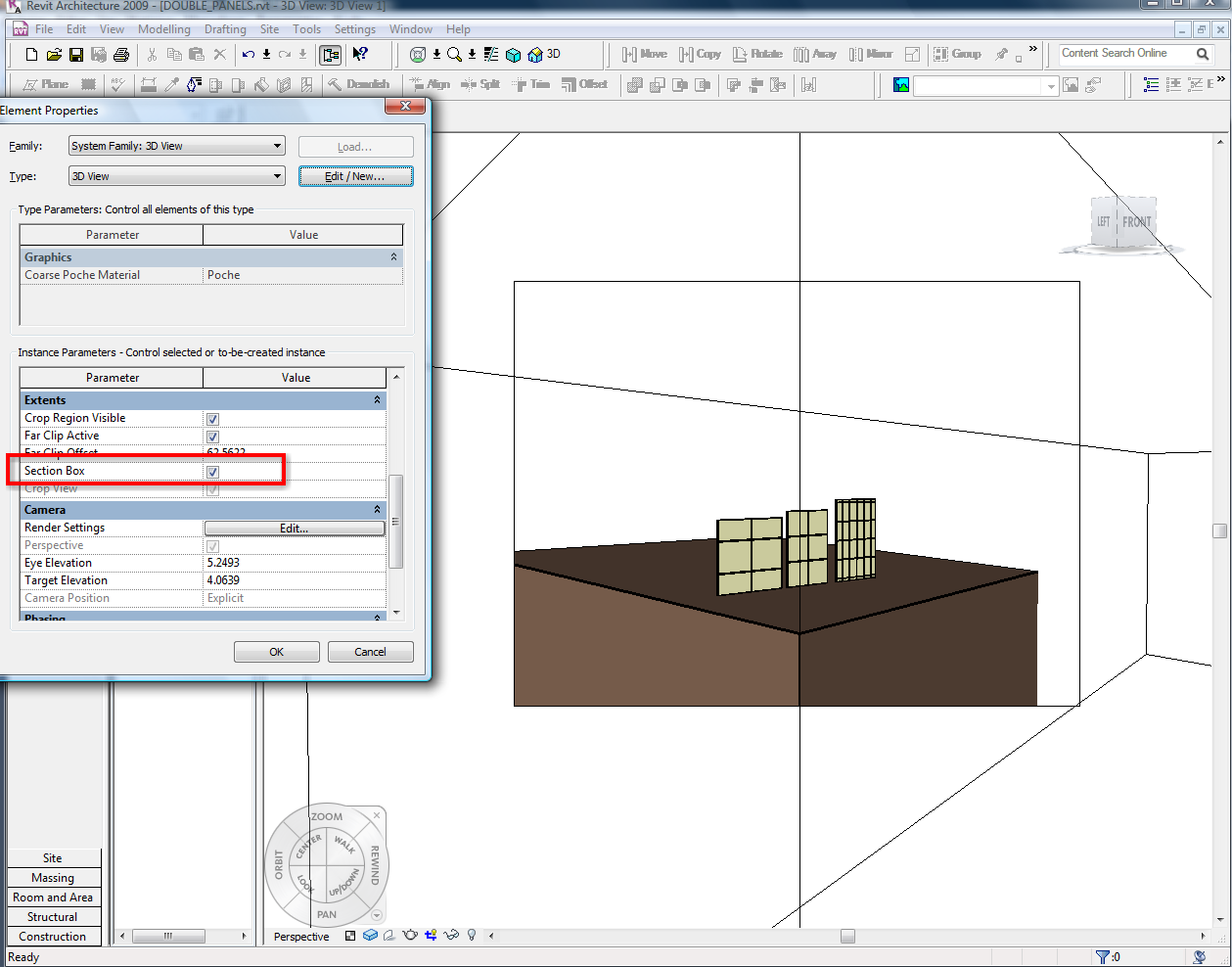

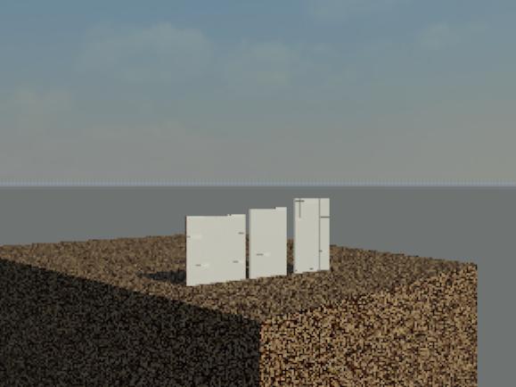

In addition how do I get my topo surface to appear with a thickness in rendering, so it covers footings etc.

You can try in that view, in VP activate the "Section box" then move the blue arrows until you get what you want, this is one way two do this...
