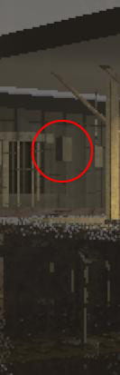

I'm having the EXACT same problem.  Everything is perfect. except that I cannot for the life of me get these things to emit any sort of light.  I d not understand families, nor can I make my own, so manufactureres providing their models are crucial to me.
Any help will be much appreciated.  you'll see the partialrendering below - note that the VISA light (circled in red) just renders as a brown box.
 Help!
