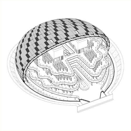

I've created my studio project using a blended sweep, so I have an irregular shaped building envelope. I would like to support that envelope with a truss system a-la free university of berlin (the picture of this is below). The trusses would wrap around this almost spherical building (but an irregular shape). Do you have any suggestions on how I could make those?
Perhaps wrap a railing?

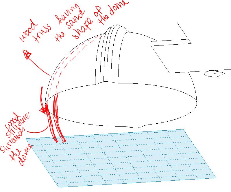

I have the same problem here. What is the solution to this? How can I make the truss having the same shape as the dome? I have attached a picture showing what I wanna do with the truss.
Can anyone help me =)
Thanks.
I tried using the in-place model for the truss which extends down to the floor to support the dome. I have no luck getting it done...
Wed, Oct 27, 2010 at 7:08:08 AM | Curving a Truss to align with a mass
You would have to build a truss family to that shape.  For something as special as this, you can't expect to do it with "stock" items.
Build 1/2 truss in a family with extruded or swepth forms.  I would not try to make it parametric.
