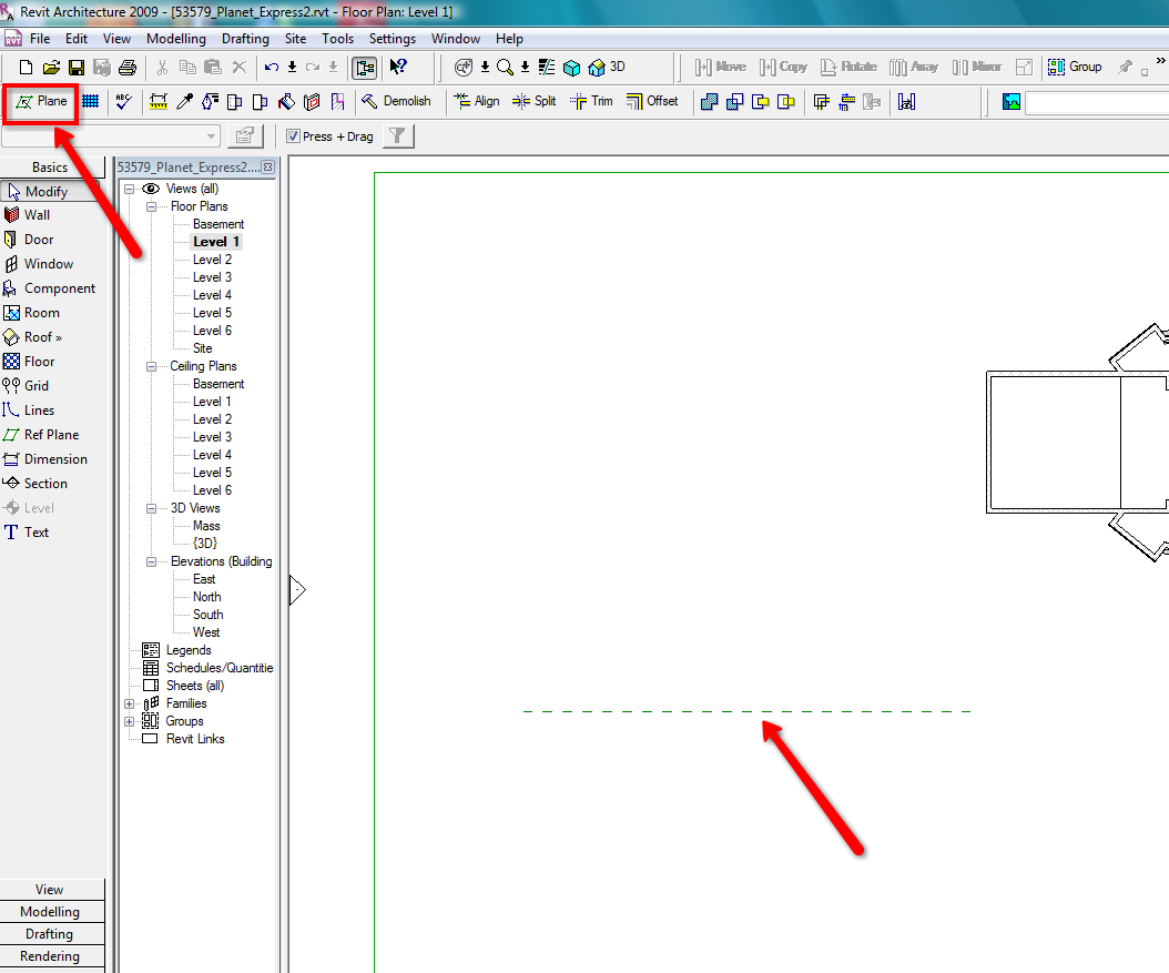

Look, create a "Ref Plane" in your plan view, then go to the "Work plane" and select "Pick a Plane" pick in that Ref Plane, now you can choose the view you want to draw, select elevation or Section view...

Yea? It's still not letting me pick the reference plane once I change to elevation or section view? I must be missing something???????
