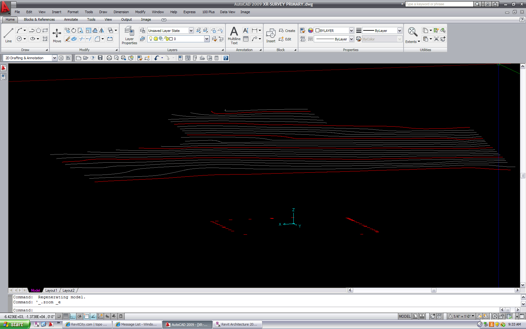

I have a 2d AutoCAD topo survey drawing that I wish to turn into a 3d Revit Topograph survey.  What is the esiest and quickest way of doing this, I know revit could select it by imported layers but as its 2d this doesnt work! any help would be app ASAP as I need to show the bosses how it can be used!

Do you have the "Contour Lines" in 3D??? Points in 3D???

no its all in 2d....... completely flat!!!! lol

if you open your 2d in Auto CAD change the elevation for all the countor lines then re-insert.
Once in revit, go to "TOPOSURFACE" TO CREAT IT, INSTEAD OF USING "POINT" USE THE "USE IMPORTED"
THEN "IMPORT INSTANCE" THEN SELECT YOUR CAD FILE THEN A "ADD POINTS FROM SELECTED LAYERS" WINDOW WILL OPEN THERE SELECT THE AUTO CAD LAYERS YOU WANT TO USE FOR YOUR TOPO THAT SHOULD DO THE WORK, BUT DON'T FORGET TO "CHANGE THE Z VALUE IN AUTO CAD FOR IT TO WORK"
SEE ATTACH IMAGE
