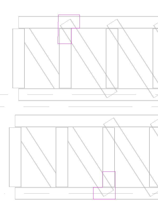

Is there a way to "cope" the ends of memebers of a truss, especially the web members, so that they fit nicely together without having them appearing to be separated?  See pic.

It is just one of the standard truss families.  It will be a steel tube truss, with welded connections.  I would like to have the ends of the diagonal webs angled to fit into the corner made by the vertical webs.

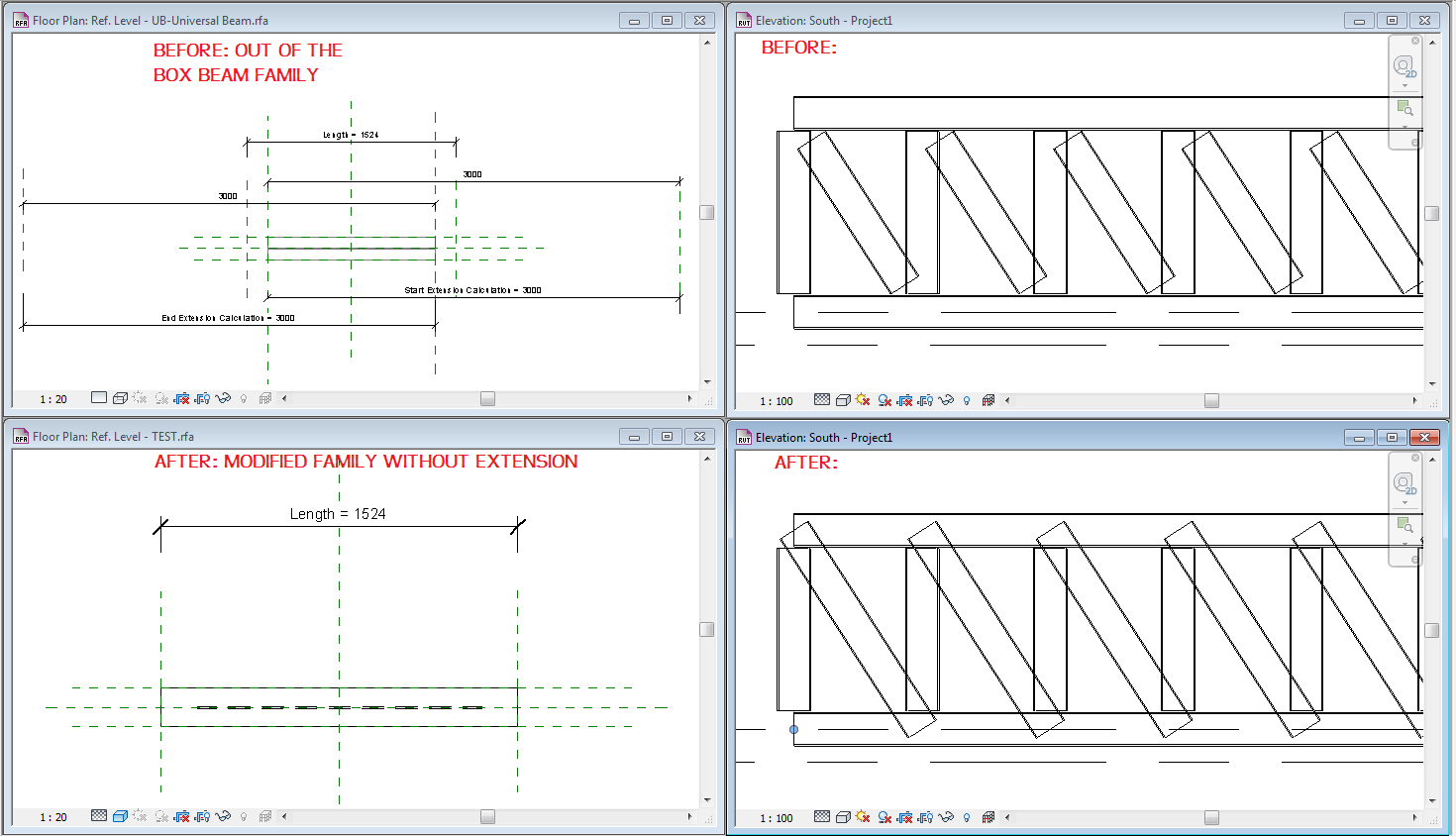

Tab to cycle through and select individual chord, or web member.  Unpin and pull the grip.
Thu, Aug 28, 2014 at 12:57:03 AM | Cutback on truss member ends
ronmalit
Joined: Thu, Mar 29, 2012
113 Posts
5 Stars: 3 Votes

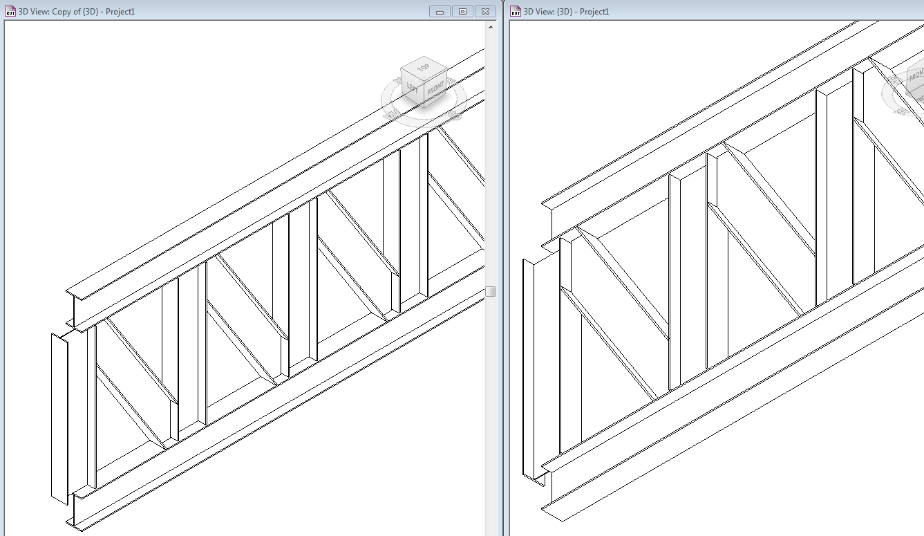

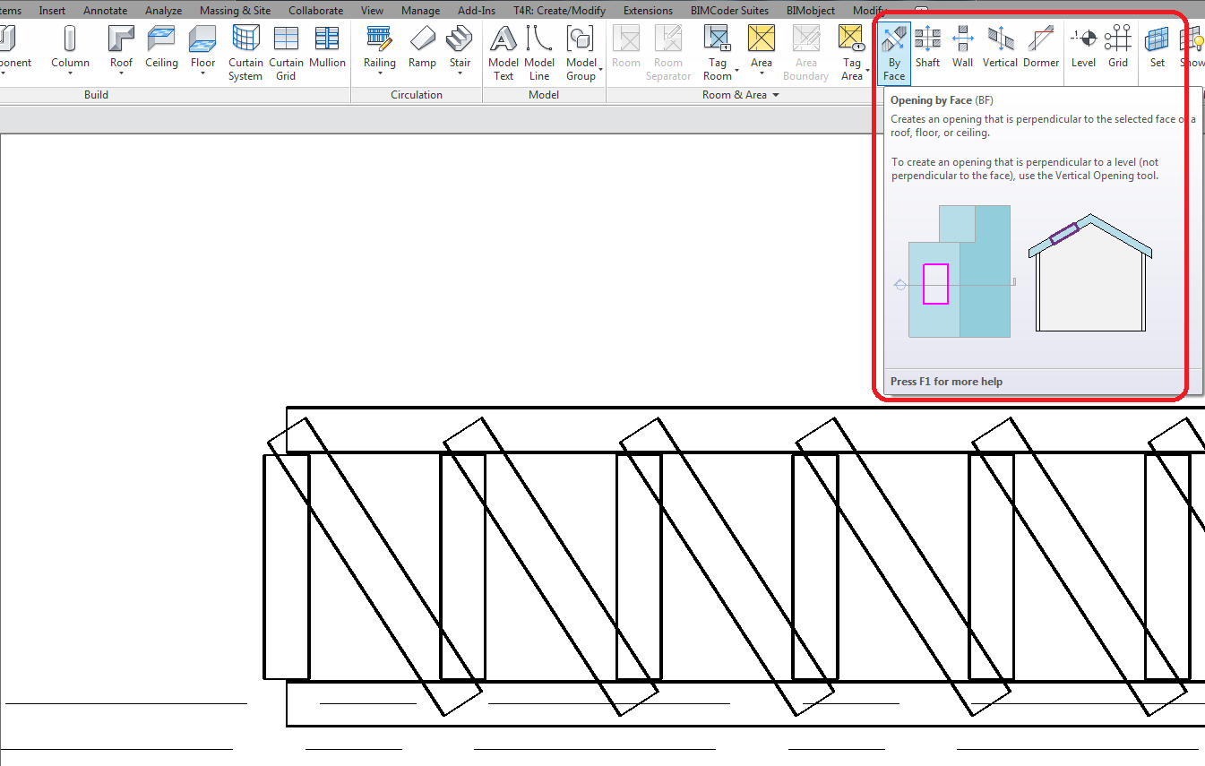

Hi
hope this will give u an idea
1.modify web family (structural beam family)
2. use COPE  Cryingor cut opening by face to clean the join)
see attached images. ty
Edited on: Thu, Aug 28, 2014 at 2:27:54 AM
