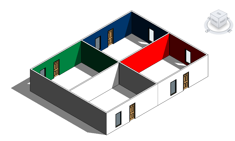

Is there a way to paint different rooms different colors? I've added finishes to the structure but that changes the entire wall, which is used for several rooms. Is it the split function?

Hi KenoshaChick, are you talking about something like the image?, if so, yes split them and duplicate them according to the color...
