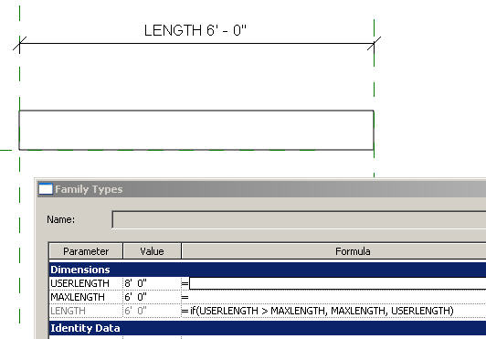

How about this?
if yes/no statement controlled by if yes/no statement
