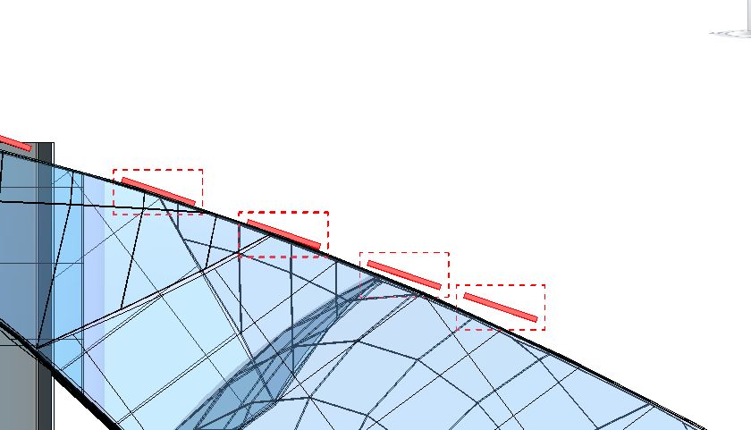

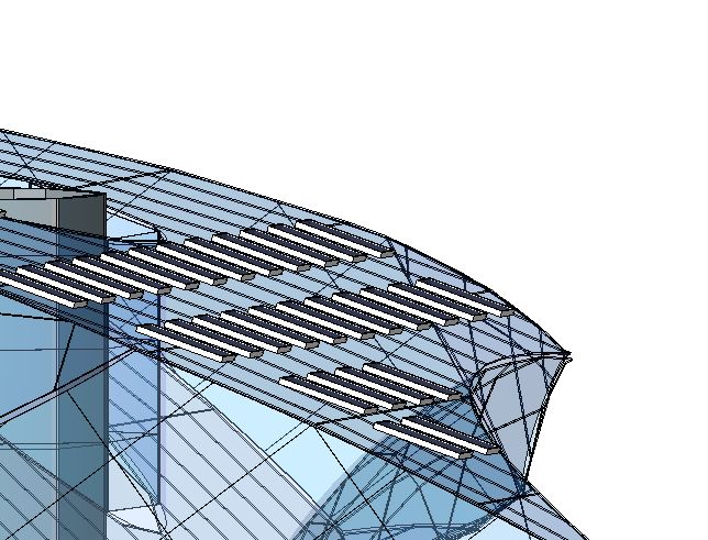

Hi.
I'm trying to figure out how to "bend" my workplane to fit any given surface.
For example to fit solar panels to a curved roof (pictures)
any ideas / solutions ?
 Thx
jw
Tue, Feb 24, 2009 at 8:03:44 AM | How to bend my workplane to fit curtain surface... ?
Joined: Tue, May 22, 2007
5921 Posts
4 Stars: 205 Votes
Create those panels in a "Generic Face Based" family...
Tue, Feb 24, 2009 at 8:05:40 AM | How to bend my workplane to fit curtain surface... ?
Obviously a plane is always flat  ... that's why it's called a plane.
Fitting flat surfaces against a curved surface is always a problem ... including in real life.  If these elements are not set to always vertical, maybe you can polar array them if that is an arc that you can define.   Otherwise - adjust them visually to a best fit?
