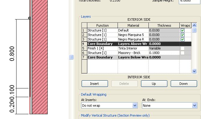

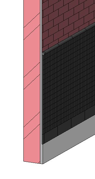

Hi everybody..
Why does this wall does not show the correct material ???
 Tks
Revit 2009

Quoting WWHub from 2009-02-23 07:33:38
"When you define an element, you assign it a material but the graphics for that material  is controlled by ... settings/materials."
That is not the problem, the problem is that the material displayed is not the correct one, instead os displaying the plaster material, it's displayng the core material instead....

Mon, Feb 23, 2009 at 9:19:50 AM | Walls Behavior ????
Revit does what you tell it to do.  Post  a screenshot showing the properties of this wall.  If it is showing the core material, then either you assigned this material to the finish layer or you have no finish layer at all.

Quoting WWHub from 2009-02-23 09:19:50
"Revit does what you tell it to do.  Post  a screenshot showing the properties of this wall.  If it is showing the core material, then either you assigned this material to the finish layer or you have no finish layer at all."
Like you ask, as you can see, the wall is showing brick, instead of plaster...
Joao Cercas
On Revit 2010 (SP3)
Mon, Feb 23, 2009 at 12:31:11 PM | Walls Behavior ????
Where is the plaster????  I see brick and I see default ... whatever that is I don't know but it sure isn't plaster..

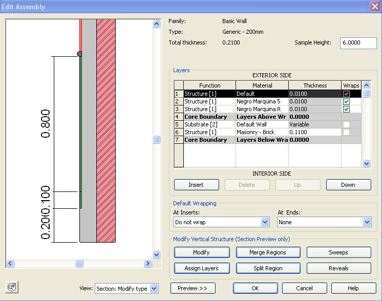

Cercas, não tenho aqui o Revit mas o 1º Layer onde tens o material "Default", que material tens assignado?? Reboco ou Tijolo (Brick)?? pela imagem é tijolo, duplica esse material, faz o "Rename" dele e altera para o material que queres, por o que WWhub e o Bronco4life dizem os materiais que tens assignados nas propriedades são aqueles que estão a aparecer na parede da imagem que colocas-te, verifica os materiais outra vez para ver se não à nenhum engano....

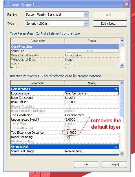

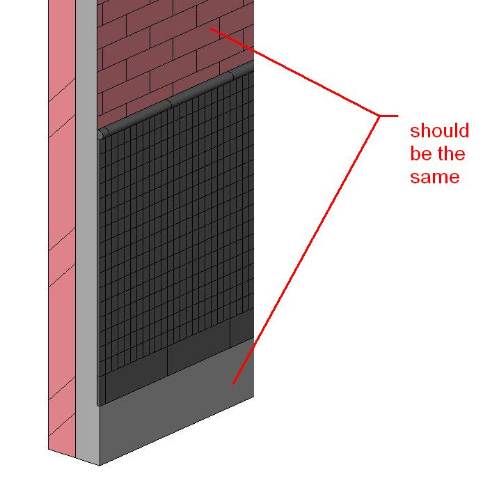

Let's try again....

This is a bug and has yet to be fixed.  Even in 2010.  To make this wall do what you want you should used a stacked wall instead of a basic wall.  This should work.

Quoting broncos4life from 2009-02-25 09:25:31
"This is a bug and has yet to be fixed.  Even in 2010.  To make this wall do what you want you should used a stacked wall instead of a basic wall.  This should work."
Tks, just as i thought ...
Hope to see this fix in the release edition of 2010...Winking
