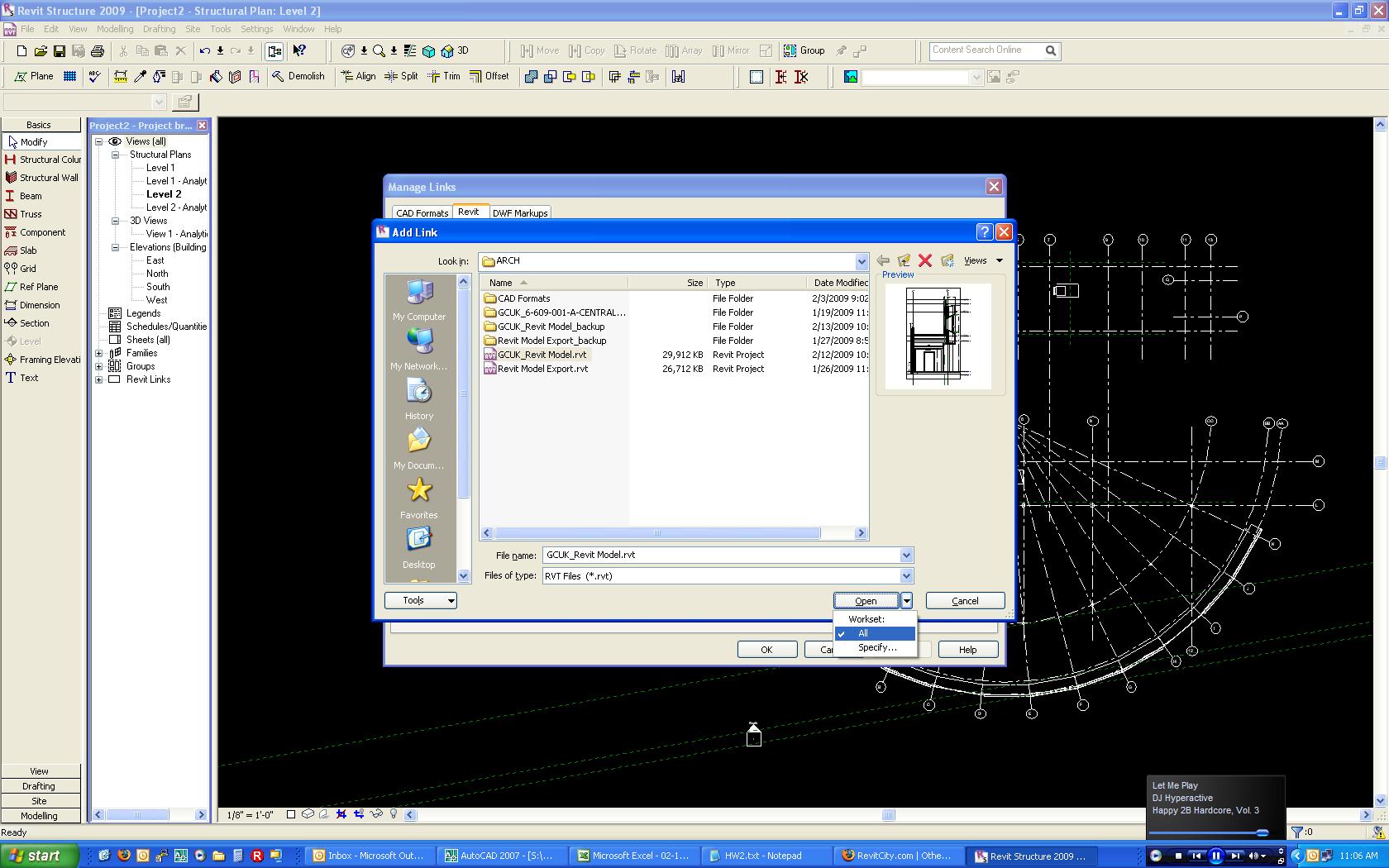

I have linked in an architect's model.  I heard I can manipulate their model's worksets from my host model?  Is this possible and where do I find this stuff at?

you can't edit/modify a linked file.

I got it
 you can turn on/off any workset of a linked model, but it islimited to WHEN you can do it:
1.  File > Import/Link > Revit...
2.  Locate your file to be linked
3.  Click the fly-out button to the right of "Open" and click "Specify"
4.  Highlight the worksets you do not want to see can click "Close" to the right
5.  Click "OK"
To further modify worksets after linking in a file:
1.  File > Manage Links...
2.  Locate your linked file and click "Reload From..."
3.  Repeat step 3 above
We will sometimes ask the architect to put certain elements on a special worksets that we want hidden in our sections.
