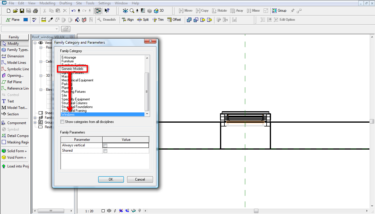

 Having built my building shell and put a roof on it I would now like to add some velux windows on the roof slopes.
 Any clues?
 I tried to create a reference plane with the slope of the roof but when I try and add a window they still seem oriented vertically and don't want to intersect with the roof.
 TIA
SemiD

To insert windows in roofs you must choose the right windows, by default Revit install a few ones but if you go here in Downloads section I think there are severals, then go to windows>load choose the windows and insert in the roof....

I did download the velux from the download area but have the same problem.
 I set a reference plane along the slope of the roof but it is still not keen.
 Do I need a curtain wall or should I be able to insert a window directly into the roof slope?
 TIA
SD

You don't need a curtain wall, you should be able to insert the window directly in the roof slope, are you selecting the right window??? in the option bar, on the left you have the menu where appear al windows in the project, check when you click in windows if the Velux window is selected...

Hi SemiDeatched, I have tried already with the window you downloaded from here, it was made from a .dwg file in a Generic Model family type, so what you have to do is to change it to a Window family category (see image). Open the family file, go to settings/Family Category and Parameters... and then change to Windows....Hope it helps you....

Perfect!  There is no way I could have spotted that!  Worked 100% as soon as I tweaked that.
ThanksSD
