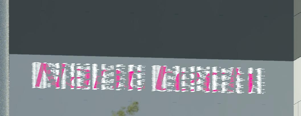

I have a company logo that is a jpeg that I’m trying to use as signage. I created anew decal and placed it on the structure. The issue is that the jpeg has a white background; I just want red letters. I brought the jpeg into Photoshop made the background black and the text white to use as a cut-out; with minimum success. It appears that the size of the cut-out is incorrect; I have tried for hours playing with the size of the cut-out.  Is there a way to use a decal with no background?

Use a PNG file.... it create an Alpha channel and the background it's transparent...

Or .tiff file........
