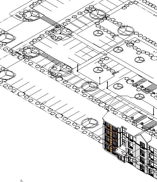

You must be doing something wrong.  Attached is a 3D image showing part of a building and a 2D site plan inserted at 2 different levels.  Works the same for a plan that just has a column grid.

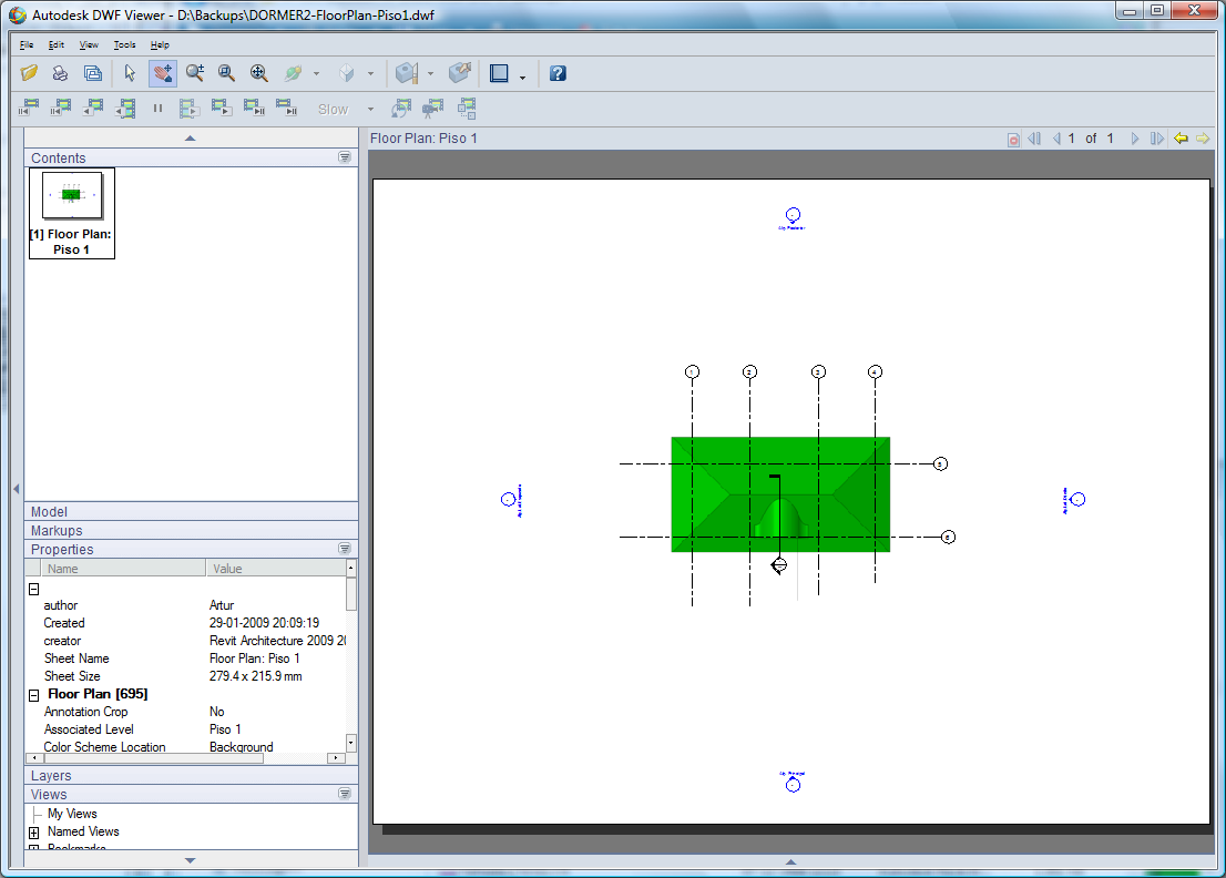

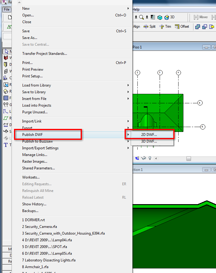

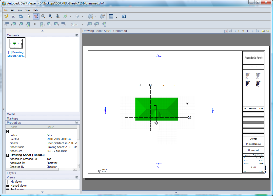

Please see the attached PDF file.  Am I missing some steps here?  Thanks.

I must apologize ...  I knew that the 2d worked in 3D revit.  I did not realized it would not work in 3D dwf.
