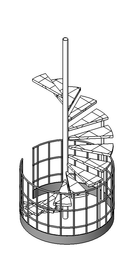

I am new at Revit and have  problem with the raililng for the spiral stair.I  tried to change elemnet properties  but nothing happened.
I attached picture of the model.

OK, pick in the Rail and pick in "EDIT", now you are in Sketch mode, the lines turn Magenta isn't? so, go to your left menu and you have a button "PICK HOST" click and pick in the STAIR, finish the sketch, DONE....
