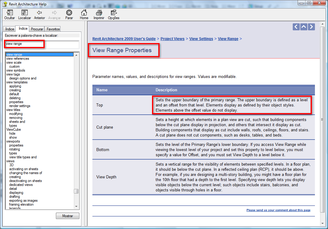

Sat, Jan 24, 2009 at 7:48:35 AM | view range top clip plane
Joined: Tue, May 22, 2007
5921 Posts
4 Stars: 205 Votes
From HELP menu...
Sat, Jan 24, 2009 at 7:56:31 AM | view range top clip plane
Bansri
Joined: Sun, Nov 2, 2008
39 Posts
thanks...
i appreciate it.
