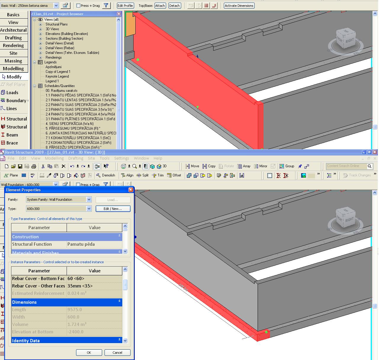

Hello everyone!
I just had a big surprise.. The thing is that I have created a specification, that includes "Elevation at Bottom" column. This is a specification of structural foundations where I can see only foundation walls. The thing is that when I set to see all the instances, this column shows for some foundation walls the value "Varies", I don't understand how can it be!

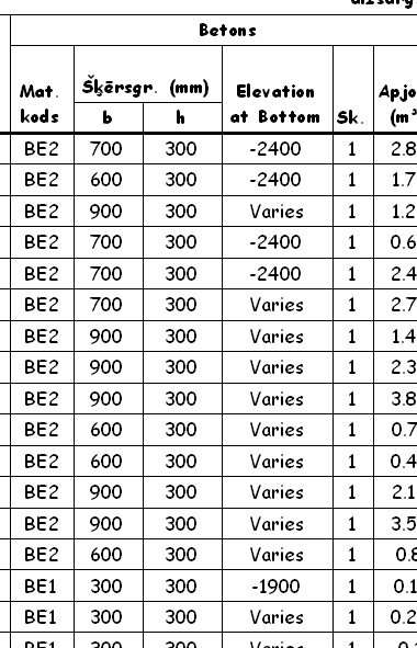

I added a picture where you can see the elevation values...

Thank you for helping, but they are already itemized, when you look at "b" and "h" you see that b = 600 and h = 300 repeats many times, so the schedule is expanded..

I added another picture, there also is value "Varies"..

Actually this is a standard family called foundation wall. It is made by clicking on walls and it automatically appears under the wall..

Thank you for hepling me! I created a picture where you can see that this family is a system family and it is called "Wall Foundation" and also you can see, that it is created by Modify -> Foundation -> Wall and then clicking on the walls.
If thinking logicaly, then when looking at the picture the element in red is horizontal so the value "Varies" doesnt make sense, because  element is oriented totally horizontaly and elevation at the bottom in every point must be equal, am I wrogn?

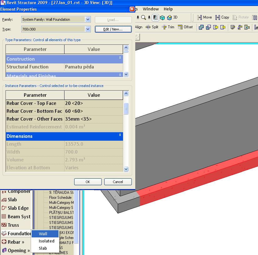

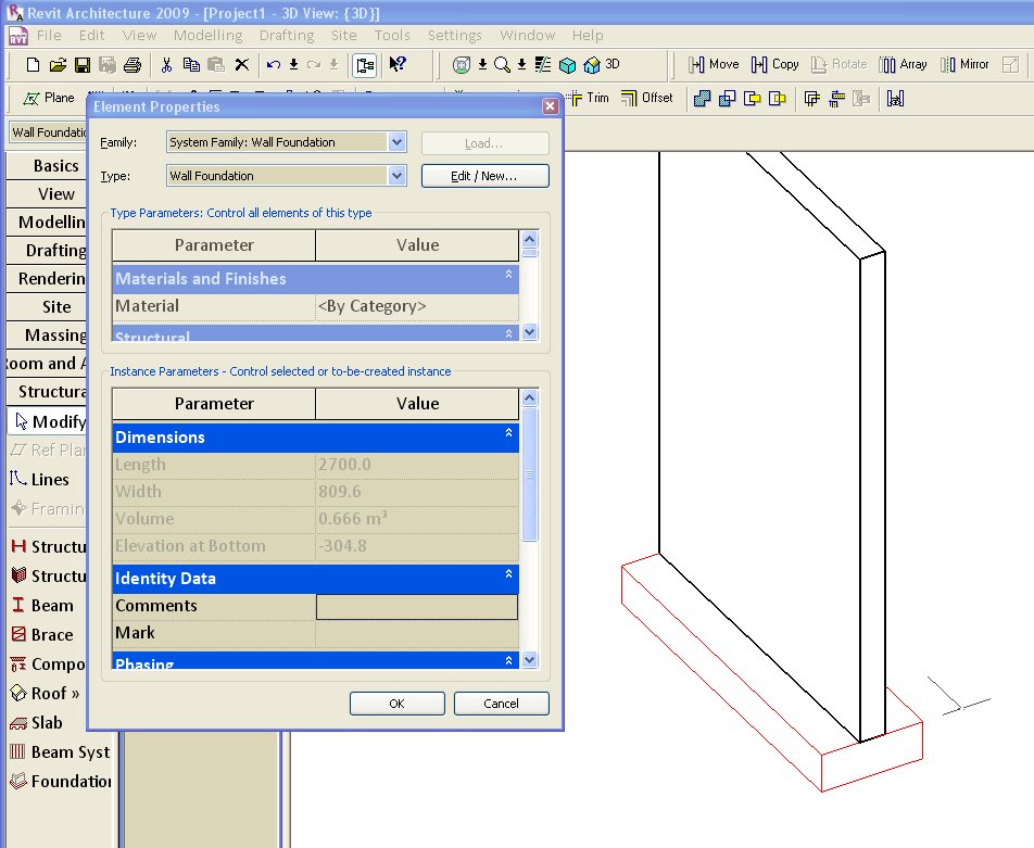

You might have old version of Revit, because I opened Revit Architecture, and under Window -> Design Bars I checked "Structural" and then it is possible to acces this function. See the picture.. This time the value is right..

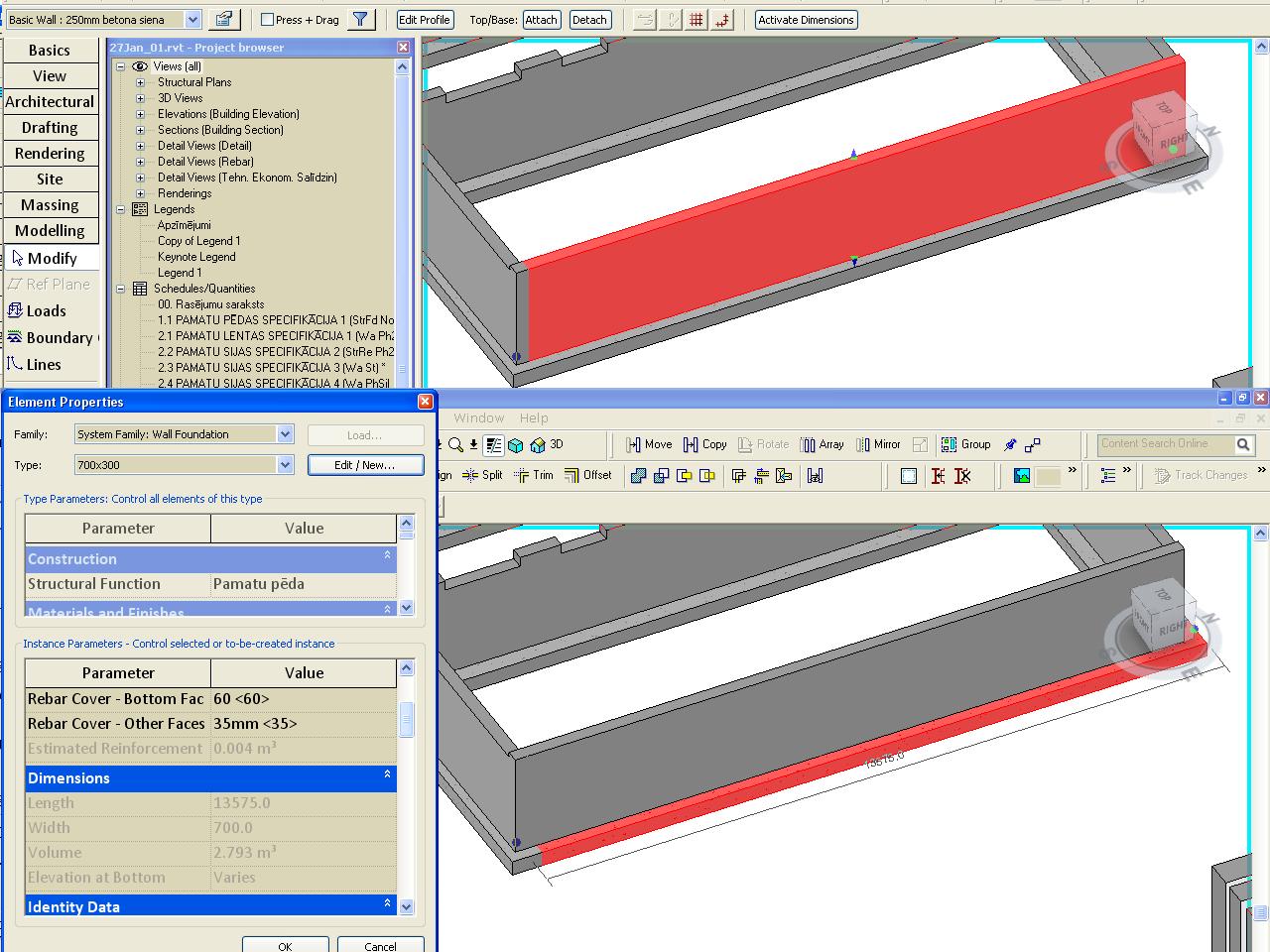

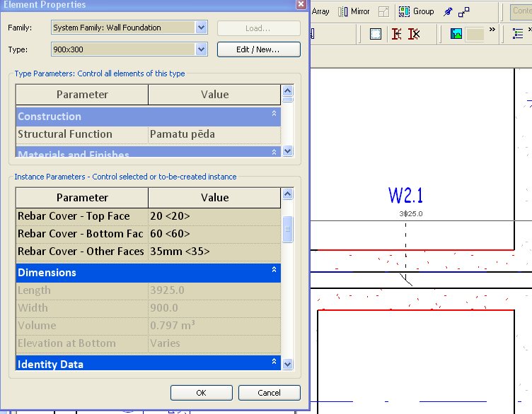

I took a look at the walls and their sketches. Turns out, that none of the wall have any sketch, only thing that has been done, is that join function has been used, but as I noticed, then it doesn't matter, because the one that was joined with the foundation slab, elevation at the bottom shows right value (see the second picture).
In first picture you can see, that when the wall is selected, then function "Remove sketch" dont appear, it means wall dont have a sketch, but the parameter "elevation at the bottom" for the "foundation wall" or footing as I say, show "varies". Strange!!!
In second picture, as I said, you can see that wall dont have any sketch, but join function is used instead, so the top part of the wall varies. Logically the level at the bottom should have some value, because only the top is modified, and it is right.. revit gives value "-2400" that is right.
I still dont uderstand these values "Varies"! I really would like not to have them. Who in the world would make a foundation footing that would have a slope? Allof the walls have horizontally oriented base, so I dont understand what is happening...
