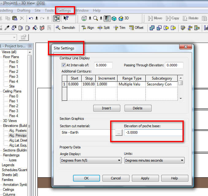

Something like this??? go to Settings>Site Settings>Elevation of poche base....

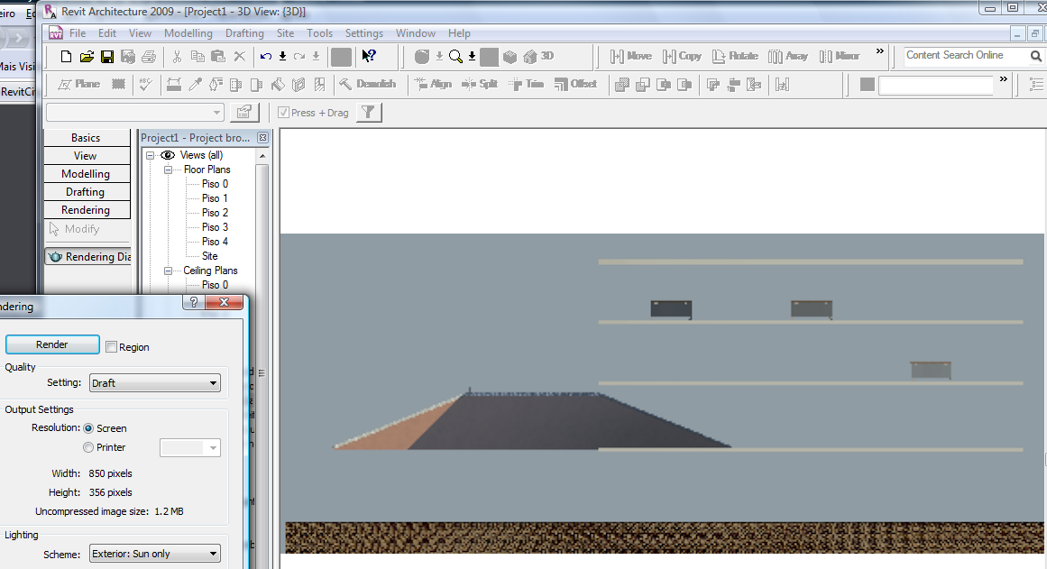

Thanks for the reply, unfortunately not what i was after, if you have a look at the attached i want to fill the void beneath the line of topography so that you will not see the reatining walls footings etc, just wanted to know if i was possible when rendering

turn on the section box in the 3d view and move it around to suit. you wiil find the section box in the view properties.

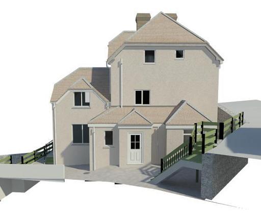

Thanks for your replies, but what i am trying to achieve is like the in the attached image

Made like Puzzle said, create a Section view in plan then go to your 3D view, in the view cube with the right button click in orient-by-plane, select sections> the section you create, then just adjust the image like you want, adjust also the section box, then pick in the section box and "Hide element"...
