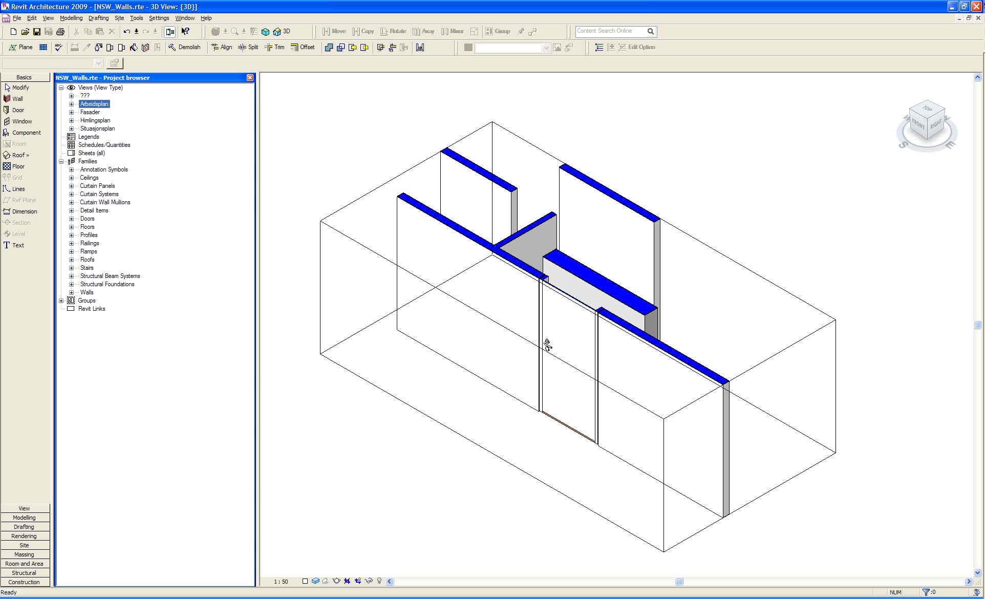

Does anyone know where I can find the settings that control the cut pattern for a coarse shaded 3D view? Please refer to the attached image to better understand my question. As you can see the cut pattern for alla objects is a solid blue fill but I can't find this setting anywhere. Any idea?

If i remember it's a "Poche" material... you can change that in Materials with that name, also check in VG, right now i don't have here Revit but take a look....

You're correct. Thanks a lot!
