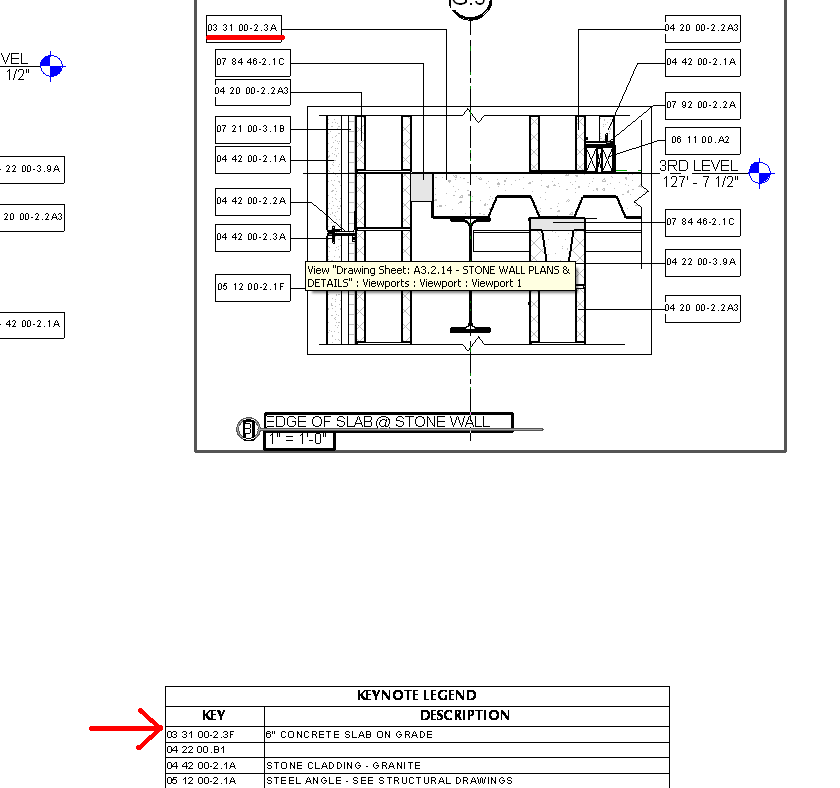

We are having a problem with Keynotes filtering by sheet.  When we pull the keynote schedule onto a sheet and select "Filter By Sheet", some of the keynotes are missing.  I haven't been able to find a pattern in why they aren't filtering properly, and when I uncheck it, all of the keynotes appear.  What settings should I check to resolve this?  I've attached a screenshot to illustrate the issue.

Sorry.  I've attached it now.  Thanks!

The problem was that the Keynotes were a hair outside the Annotation Crop line.  Thanks for looking into this!

Thank you for posting your solution. curse annotation crop.
