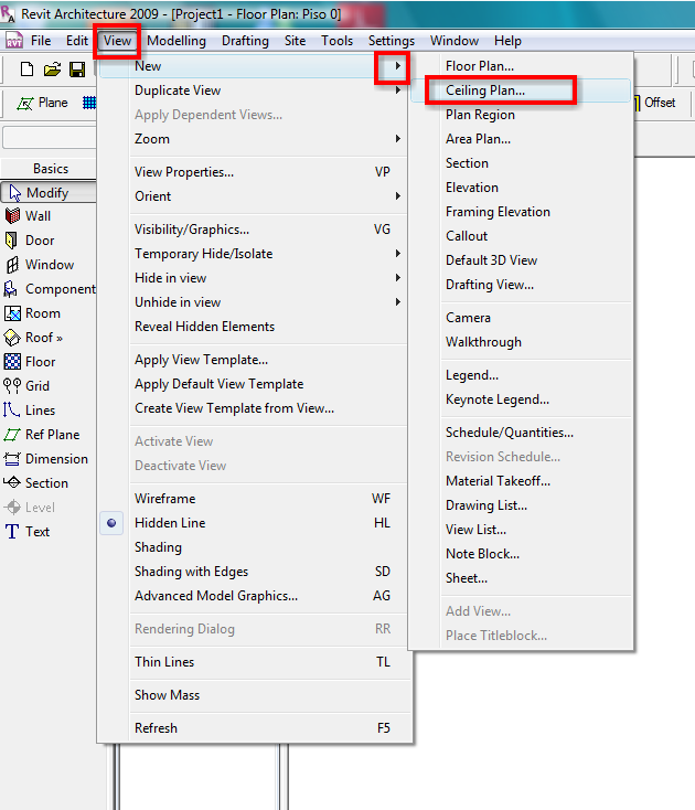

I have problem getting ceiling plans in project browser (Revit Structure 2009). In Revit Arhitecture ceilings are near floor plans by default... But now I have started a project in Revit Structure using some Revit Structure template and I can't get the ceilings (the main reason to get ceilings is to get lights afterwards). Can anyone help me?

Go to "View > New > Ceiling Plan"....

From what i see, structure does not have the capability of adding a ceiling plan.  If you need a ceiling plan in your project browser on a regular basis, I would try using an architecture template.  I have been testing the two templates against each other and the architecture template seems to work fine in structure.
