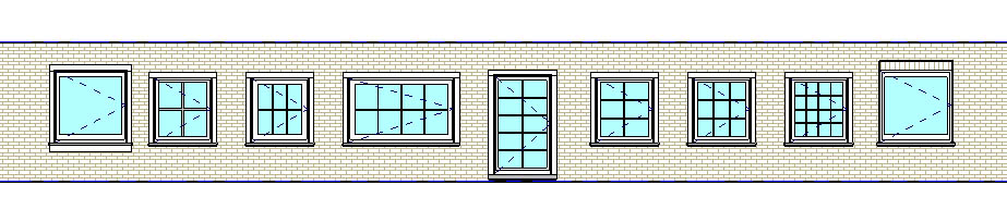

1. Truly parametric windows & doors. The ability to change each window instance, such as muntins, sash size, trim, sill, stool and so on. I'd love to be able to create a cottage style window that is 6 over 9 without having to go edit the family every time I want to change something small. Same with doors. I'd like to have a half glass door that I could change the muntins to 4 or 6 or 9 or whatever without having to edit the family.

in response to your first wish,
i have added an image of one of my window familys in its most basic different forms,
Note: this is one family Smile all changes are made with instance parameters or with preset types,
is this what you were looking to do?
