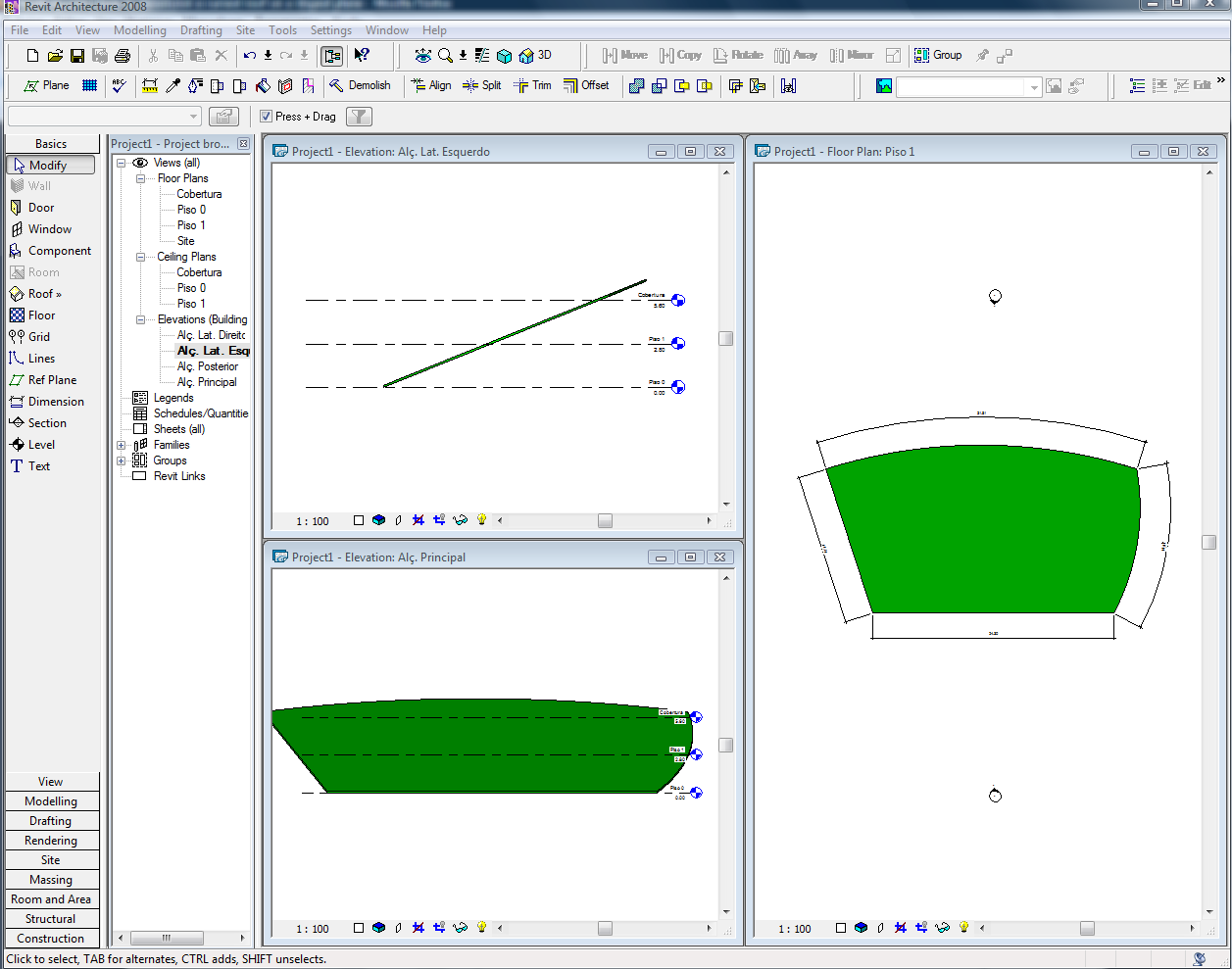

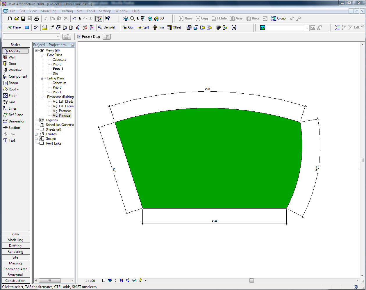

I'm trying to dimension a curved roof on a sloped reference plane.  Does anyone know a way to do this?  Revit won't even let me dimension a curved line on top of it.  Please see attached.  Thanks ahead of time for any responses.

I don't know if this is what do you need because i did that in 10 seconds, you must select the "endpoints" with the TAB key you can select them....
