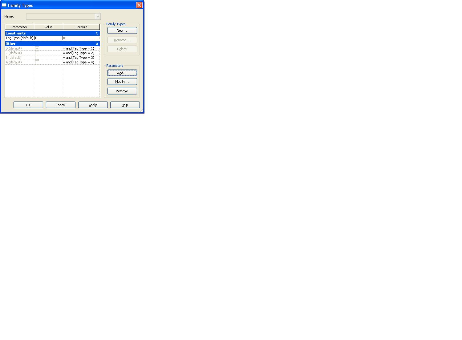

Here's how I handle this.
I create a parameter to controll the selection of the lable I want to see and set visibility parameters that will be driven by this.
 See attached image for how I set it up.
HTH
