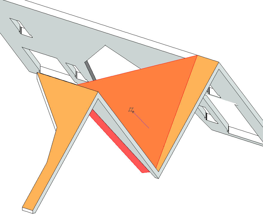

Hi, anyone got any tips or tricks on drawing this type op connection, ?

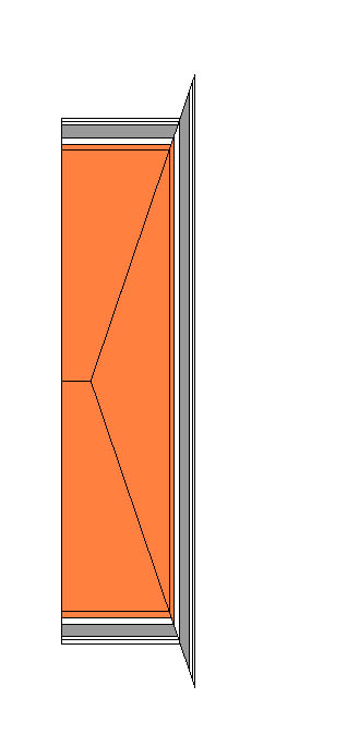

no those are two roofs with a different angle cutting in plannview

Can you post some images in 3D view to check????

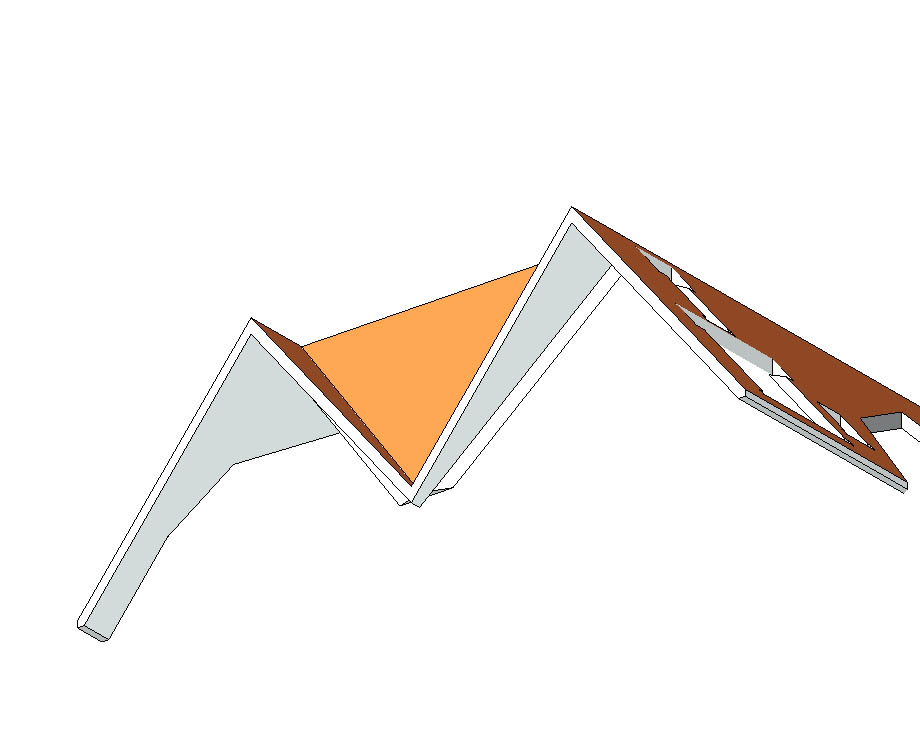

its kinda hard to get a good angle on it to make it clear, but hope this helpsEdited on: Fri, Dec 19, 2008 at 6:41:28 AM

Fri, Dec 19, 2008 at 6:42:37 AM | roofs with different angle

Well, did you use "Join/Unjoin Roof"??? That edge its a "Footprint" roof or what???

the roofs are joined and both are roofs by extrusion.

So if that edge its a extusion roof create a Elevation or Section View and Create-in-place in the same category (roof) a "Void" to "cut" those portions of roof you don't want...
