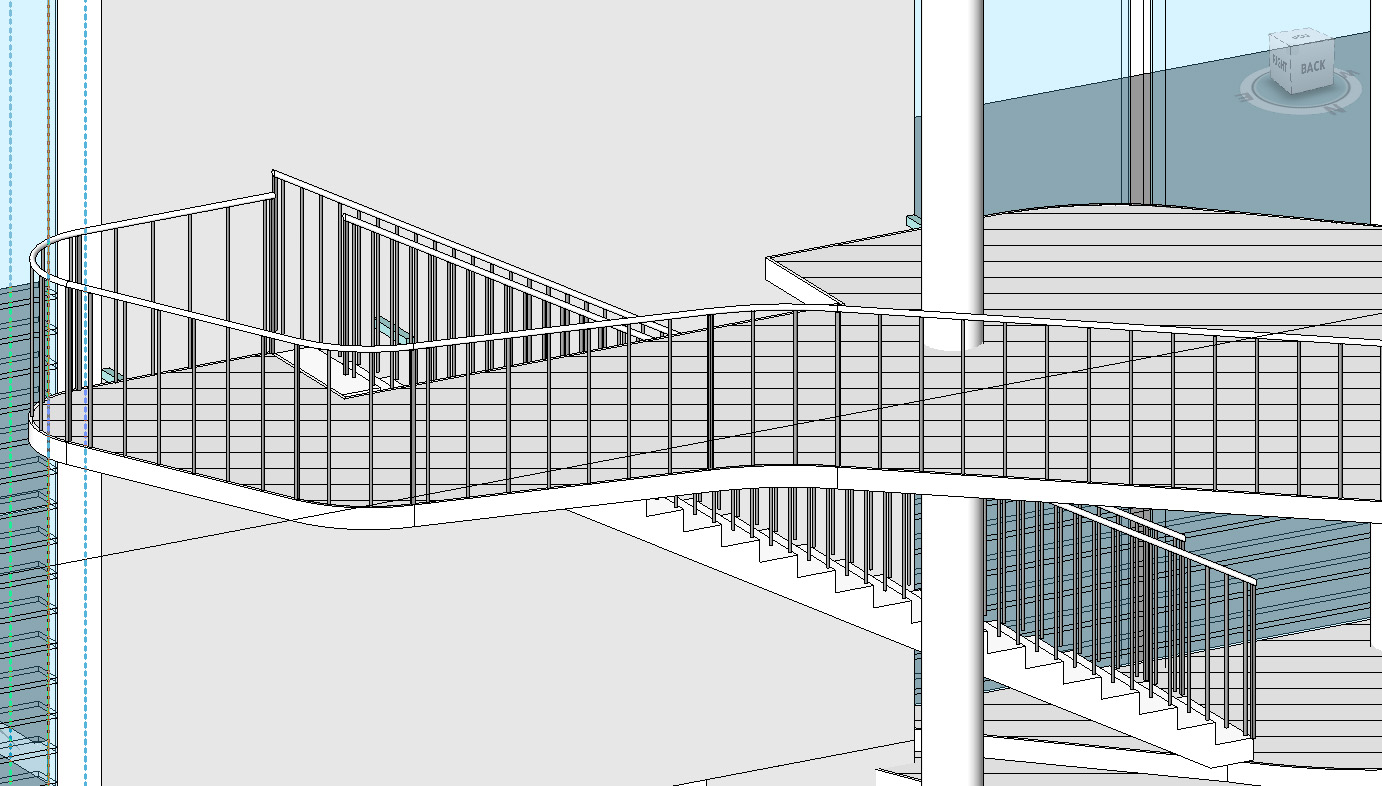

Hi,
I have a problem about my railings. The railings isn't attached to the stair itself - instead of that, they're hovering a bit above them. I was hoping there would be a simple solution for this, that I unfortunately missed during the proces of adjusting the stairs. Can someone please help me getting out of this problem?
Thanks in advance Smile
Best regards,Esben
Ps. I'm using Revit 2009

Looks like you removed your stringers but didn't move the railings. Nudge them over the stairs and you should be fine. Currently they are floating off to the side.

Yeah, select the rail, pick "Edit" and "Pick Host" in the stairs, this may correct the problem...

Worked very fine. Thanks Smile

I had this same problem before. My fault was that I turned monolithic stairs on and ignored the warning messages. The stringer showed up again when I turned it off.
