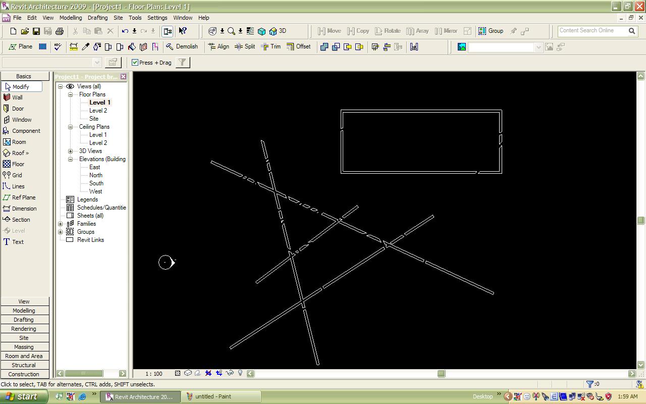

These walls aren't continuos! (they are broken when I created) Why?  help me please! thank so much!

What a hell is that? it's only in plan view or also in 3D view????

Are you working with phases?  If so you may have drawn your new walls on the existing phase.  Also try using the unjoin tool there.
Or you may have some walls hidden.

Hi all, Blake! I'm not sure... Am I working with phases?... so  when i using the unjoin tool, it's okey! But any time ... Walls are created to break cotinuously! How can i solve this?. Please show me detail more, don't you? Thank's

In your view property at the bottom what happens when you change the Phase from New Construction to Existing.
Or Hit your Lightbulb along the bottom and see if anything is revealed.

Ummm.... I never encounter this kind of problem before... just asking the same question like typhoon did, is it only happen in plan view or is it happen in 3D view too? did it happen from the first time you create that wall or did you already modify the wall? did you create it with a specific wall type or is it happening to all kind type of walls?
and blake's solution... is it worked? I think the reveal hidden object button (bulb button) is only to reveal all hidden object...

Thank's vicozzio, It's my fault... because i used "e"_ keyboard button same "erase"_ button in Acad! I found out "e" mean hidden Obj. Hit Lightbulb the bottom and anything is revealed.... So can you tell me about "wall make bearing" appear when i creat a beam under corner wall which have no any structure column here!  Hope received  your answer soon.  Thank's
