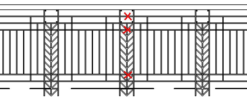

Is there a way to start and stop a rail around a baluster? See attached.

You can do seperate railings.... a real pain!  Have on railing that is continuous that has all of the continuous rails and the ballusters.  Then have seperate railings for each segment of the non-continuous rails.
Set baluster on Bottom Rail
