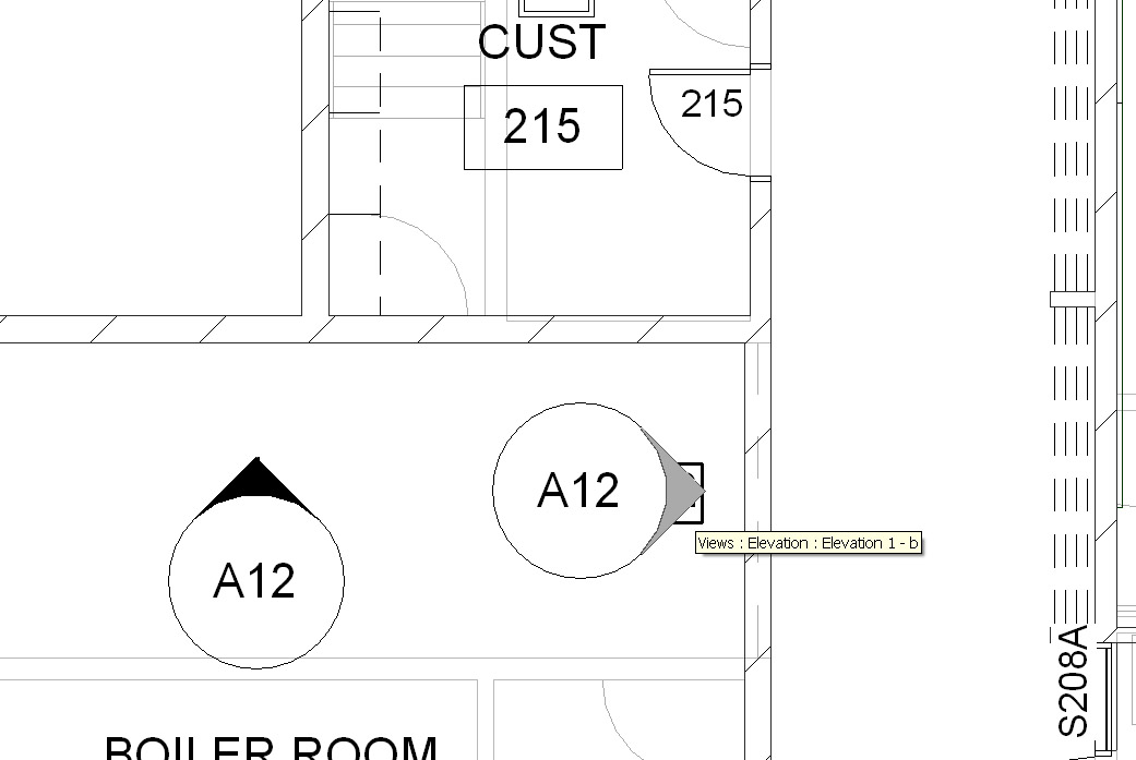

My office is new to Revit and I'm just starting into my first project using this product so please excuse my lingo. I'm having trouble with elevation markers. What is happening is when I place an elevation, the detail number for the elevation is either hidden by the filled in portion of the directional arrow or is in a position where is overlaps some other graphics. Is it possible to move the position of the detail number only? It seems to allow me to highlight the number but will not let me move it. If anyone can help it would be greatly appreciated.

I appreciate that you can change certain properties but I actually want to be able to physically move the location of the detail number on the plan view. Currently the detail number appears in the same location as the filled in arrow so you can't even see it. I had already looked in the elevation view tag properties but the only parameter referencing anything like this was the text position which only gives you the options of inside or outside (L,C,R). See attached image of the overlap.

I gave the only answer available - system level families are not yours to change.. If you want to argue with that, then take it to AutoDESK.
Change your setting to right instead of centered.

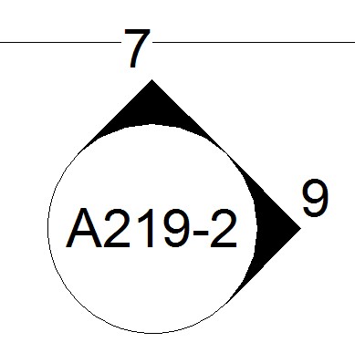

We don't seem to have a problem with how it works - see attached.

to fix the elevation tags from appearing under the filled region go to -families
   - annotation symbolsRight click elevation mark category and choose 'edit'
when the faimly opens select the filled region then select the 'edit family' button and simply move the text out from under the elevation tag.  Then reload everything back into the project.
