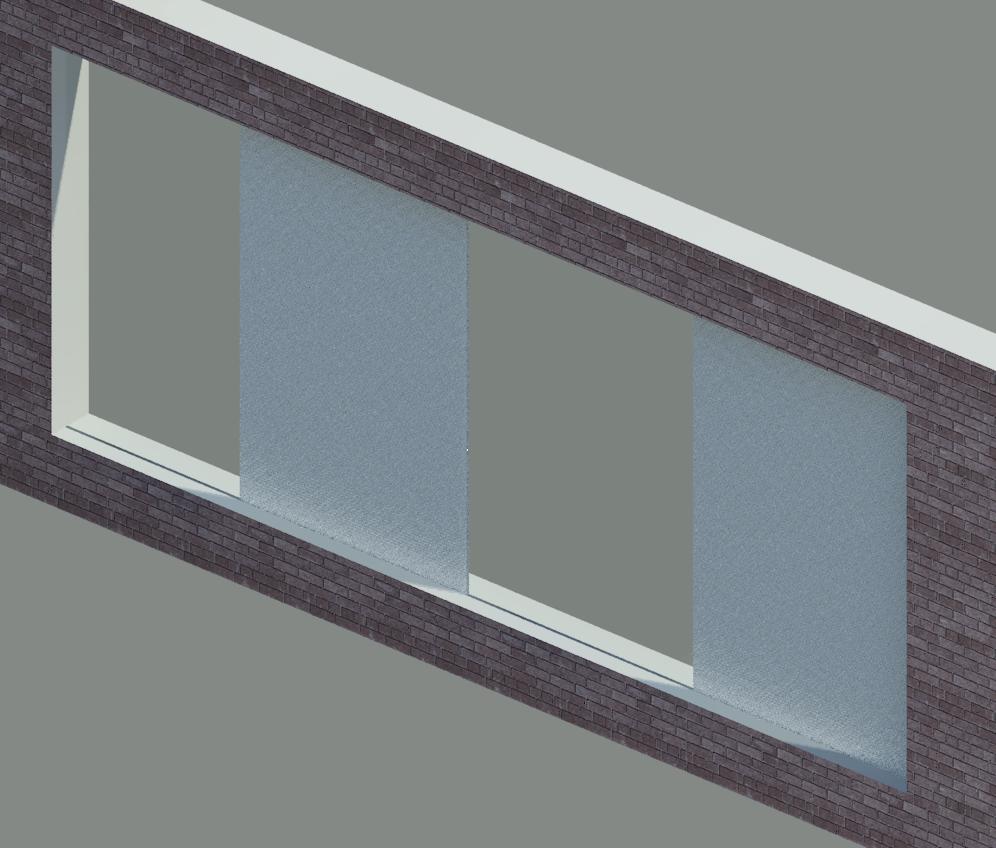

I have made my own curtain panel family but i cant get the glass to be a frosted glass type it stays at its default glass type.  Any suggestions?

Go to your mouse the Glass of the curtain wall, with the TAB key click several times until you see only the glass as selected, then pick in that with the left button of mouse, go to the propertis, EDIT/NEW, duplicate the name and change to the material you want...

One more question,  how do you duplicate the Curtain Panel: system Pannel: Glazed so that when i change the glass material that not all the curtain walls change.  I am tryng to have two differnt type of glazing a translucent type and a transparent type.

That's the vide: http://screencast.com/t/NIa6iQlAu
