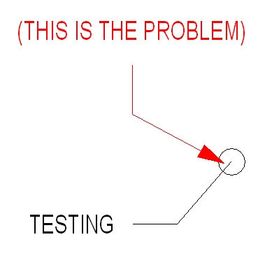

I have a feeling the answer's going to be no, but I figured I could ask anyway.
I would like a leader that ends in an open circle, and what I've done is duplicated the "open dot" arrowhead so it is larger and is more of a circle than a dot.  The problem is that the leader goes through to the center of the circle, which is fine when the arrowhead is filled but not when it's open like this one.  Is it possible to modify the "open dot" arrowhead so maybe the the center of the circle isn't at the leader end point?  Or maybe dictate where the leader line ends in relation to the arrowhead?  Or some other way of doing this besides drafting lines and circles for each leader?
I've attached a picture to clarify what the problem is and drafted lines of what I want it to look like.  This is all for Revit 2009 (Architecture, Structure, and/or MEP).  Thanks in advance.

Make a filled region circle with a solid white, opaque fill
