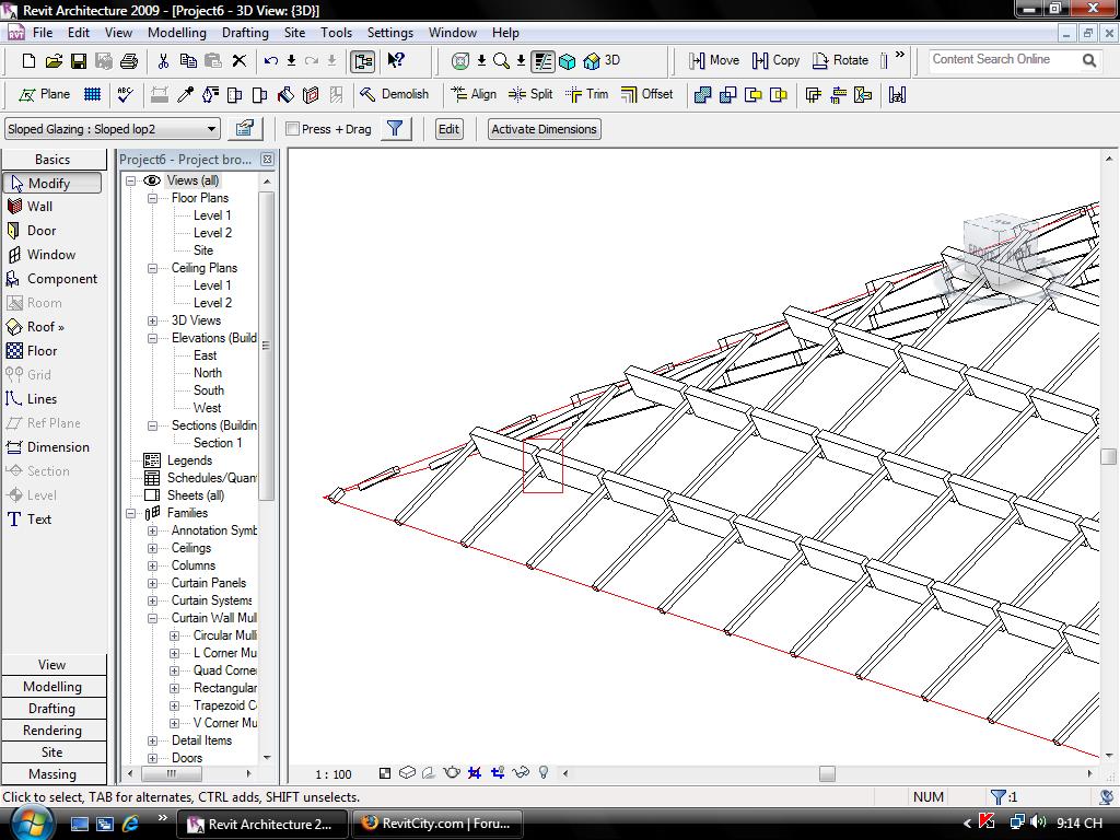

Hi all .
help me fix truss !

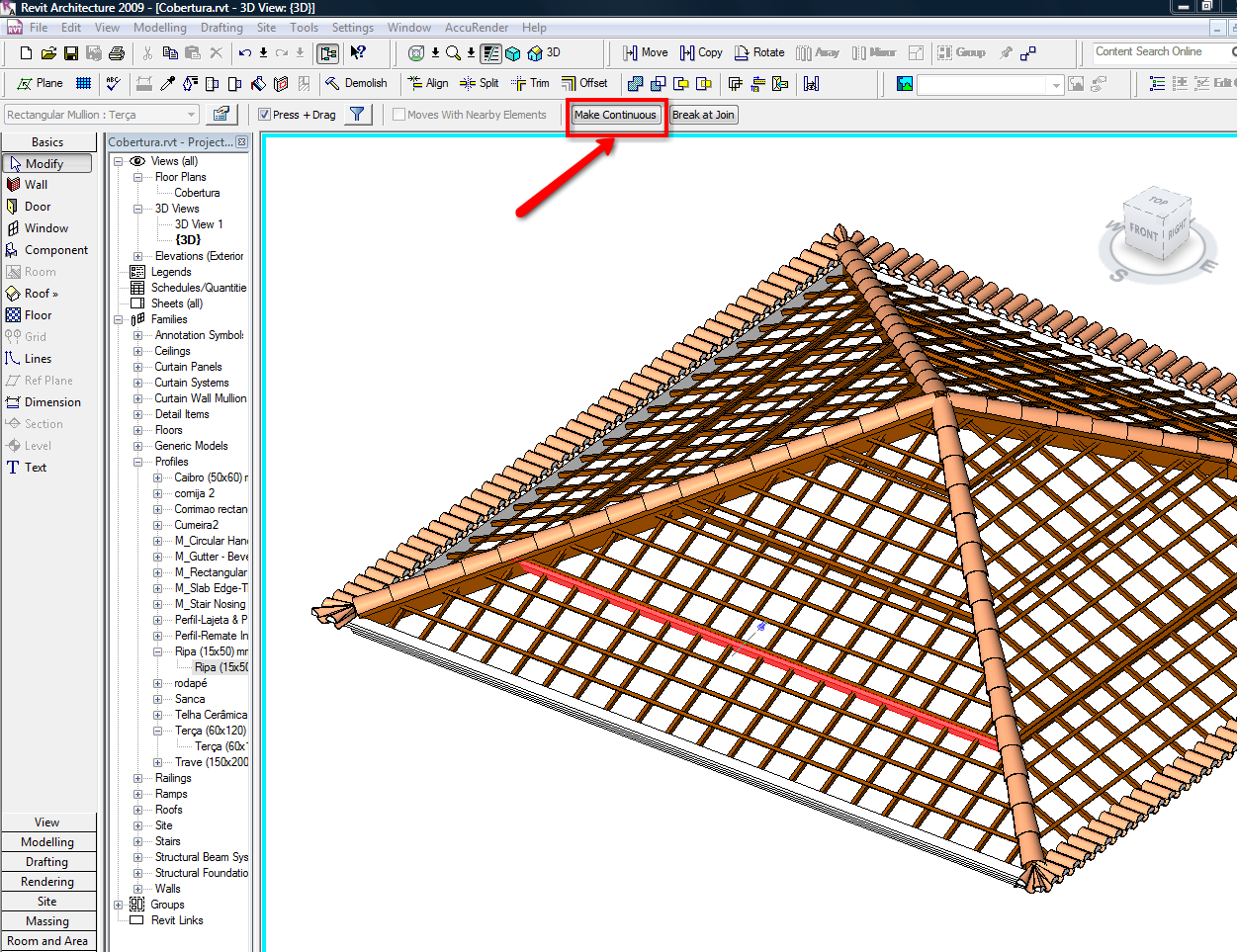

Hi, pick on the element and pick in "Make Continuous", see the image attached....

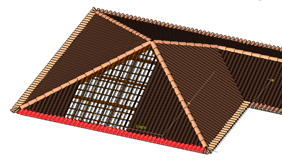

How did you create that tile?
Is each one individual?
and doingt a whole roof like that would take forever to render or bog the file down, correct?

No, this tiles ara a family like you can see in the image, the whole model you can see now in the image attached and Yes, increase the file size but this ALL 3D, when you create the section views you don't need to create 2D details for this because it's all done.... The render it's OK, my machine works good with this...

"I have done somethine similar with a metal roof. I created a profile, then did a mass, profile sweep and applied it to the angle of the roof and then copied it a million times to cover the width of the roof. That really put a hurting on my computer but I didnt know any other way to do it." - LOL...
First see this: 1º video: http://screencast.com/t/trJwHTYMmH   2º Video: http://screencast.com/t/QhyBfWqsO
This two videos explain how you can create in 3d the whole roof, NOT the RIDGES, and the Corners but the roof it self. The ridges, the corners and the edges i put in attached ....

I created roof same picture . I have a question : In a sloped glazing , how many layer of truss i can creat on .
Another question : In sloped glazing I creat two layer of truss but why do they intersection ( i want layer truss on another layer ) .
Have you video clip for tile roof ?

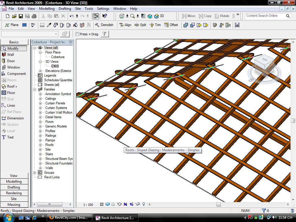

Hi, don't forget first to DUPLICATE the Roof and give them different name, see this:

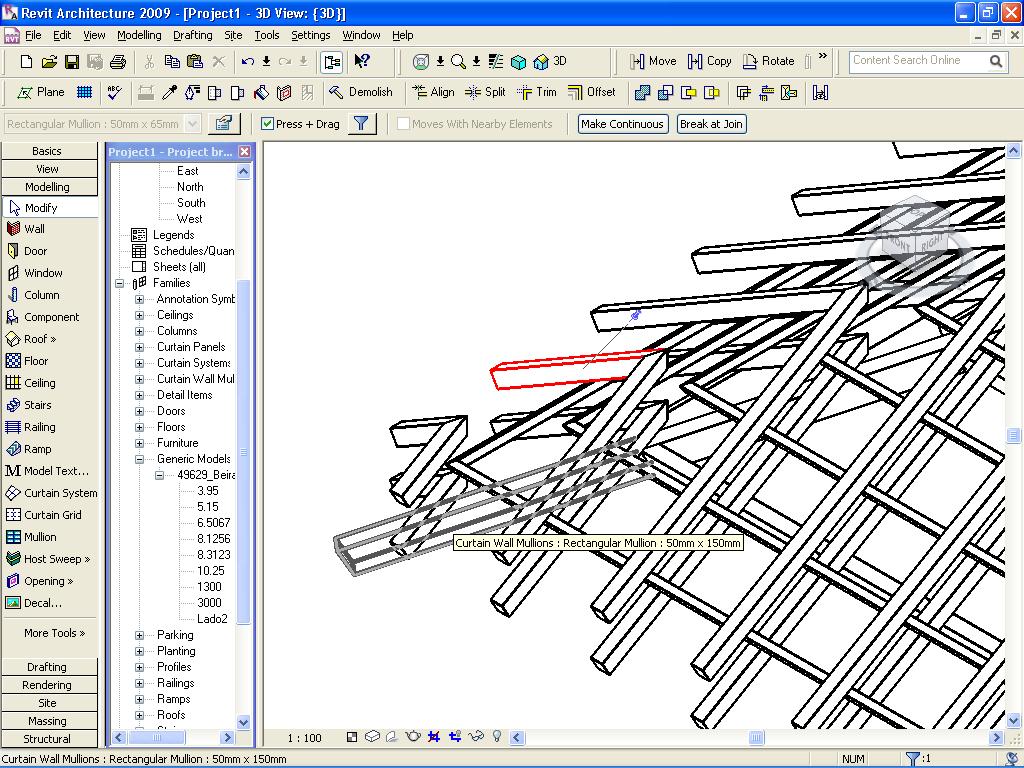

I creat wood beam finish . But slopped galzing for tile roof i can not do . The file 49629 cumeira2.rfa (profile for tile roof ?).
I saw the same your video but i can not change mullion !!!. Help me . Thanks
