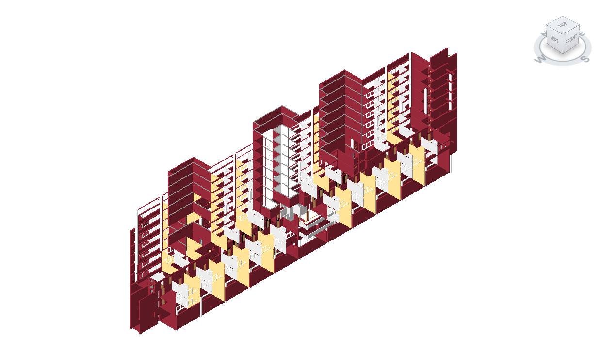

My default 3D View is missing most of my model... but the model is all there in the rest of the views and new 3D views.  Is there anyway to recreate this defaulted 3D view?  Or what should I do?  Is this happening because the file size is getting too big?

I didn't delete it but I created a new 3D view and the model showed up just fine.  How can I make this new 3D view my default 3D view?

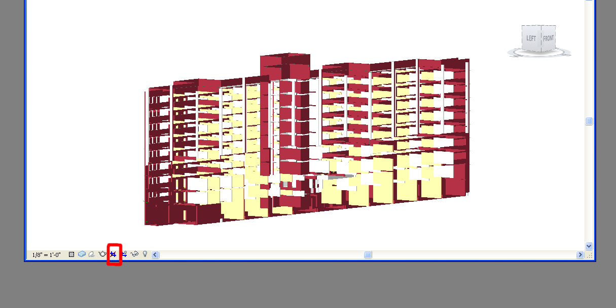

The whole model is in your 3d view... you just have it cropped.  While in the 3d view, click on the crop (do not crop) button at the bottom of the view...4th from right.

I clicked it and it didn't change anything.
