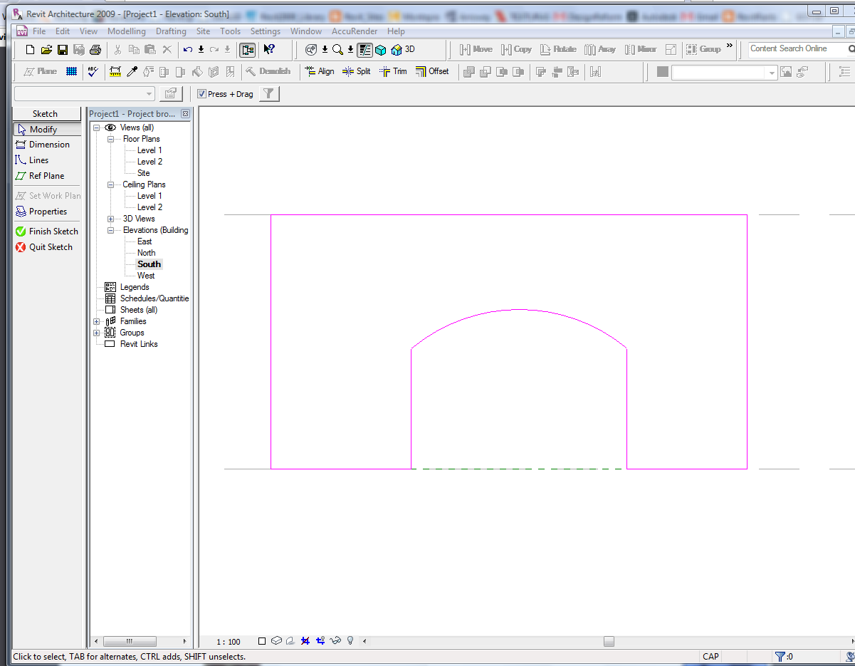

I have a query with an arched opening and despite having read a few posts on the subject i am still not quite sure how to ahcieve a simple arched opening in a wall.
I attach to this post a photo which shows what i am trying to achieve.
I am happy creating a rectangular opening using the "opening" tool but would appreciate some help making it arched or recatangular with a semi-circular arch on top.
Hope to hear from you soon
Mon, Dec 8, 2008 at 6:00:30 AM | help with arched opening
Joined: Tue, May 22, 2007
5921 Posts
4 Stars: 205 Votes
Hi, don't use the "Opening" tool, go to the "Elevation view", pick in wall and pick in "EDIT PROFILE", then appears 4 Magenta lines, create the shape you want for your opening, then "Finished Sketch. (see image attached)
